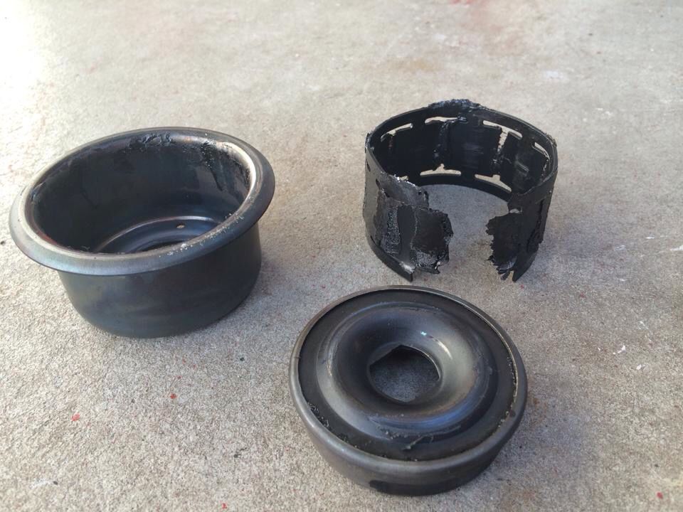

Rookie error..........I somehow put the release bearing on backwards. Hence the sqeueal and hard clutch pedal.
Burnt out the bearing and stuffed the sleeve. Good one.

Thanks Kennomini. All back together now. New bearing and second hand sleeve was $30. Bargain.
No damage to the spring on the pressure plate Mick. I only pushed the pedal in about three times and moved the car about 2 metres so all good.
