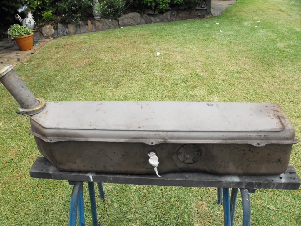

What year model is your van Mr Orange , i have a 77 van , here's a pic of the tank , i'm not sure which pipe is the breather , i'd have to have another look , i thought it might be the pipe that you can see , or it might be the fitting that comes from the backside of the
neck filler that you can't see in the pic .

It's a '73. That all makes sense as the charcoal canister ADR came in between our two vans.
Thanks, will take a look into it. Looking at the tank this afternoon it's leaking from underneath somewhere so I might look into getting a custom one made up. Good excuse anyway, can barely get 200km out of a tank with the 1275...
