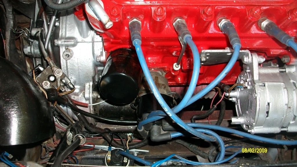

thanks, hope you can see
PostPosted: Tue Apr 05, 2011 7:16 pm
Give Ash some flowers Nick .
Posts: 10149
If you dizzy is set up correctly (like Mike Byron stated above) then you have the leads in the wrong position.
Currently the leads (as shown in the photo) go 1-3-2-4.
You need to swap the plugs on cylinders 2 and 4 (1 is closest to the radiator). The dizzy spins anti-clock wise when the engine is running.

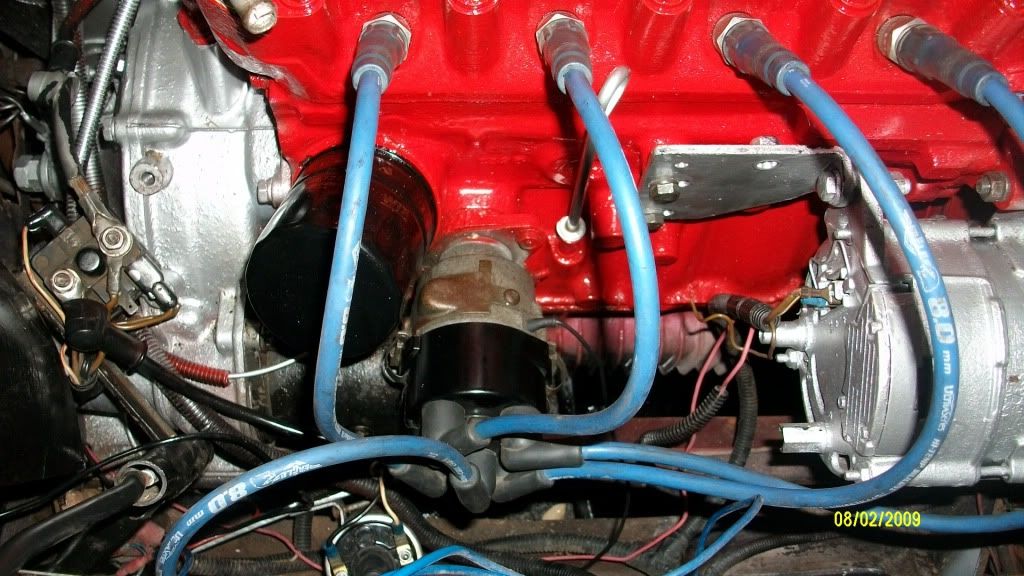

Ok how about now -
It's still not starting, maybe the problem is something else. I cleaned the plugs as i thought maybe it was flooded. There is a strong spark and they were wet from getting fuel

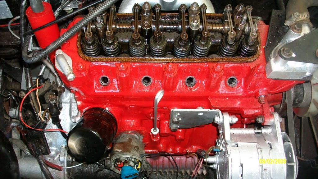

Here is the rocker cover off, does this timing look ok?
I will replace the spark plugs as i broke a couple taking them off .
