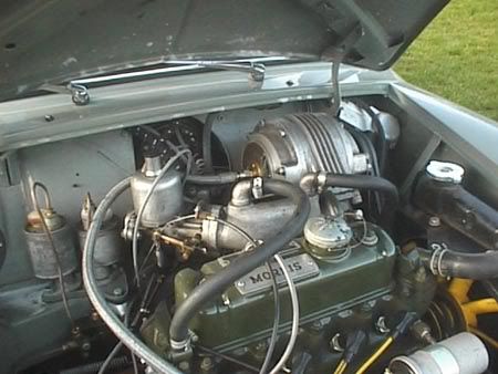

i have also seen a shorrock supercharger fitted to an 850 and apparently you get around 25 to 35% more HP.
here is a pic:
cheers

I do like the supercharger idea... get everything balanced and use the 12g202 head....

im sure john cooper would have pissed around with an 850 when he first got his hands on it.. and all the works teams. that supercharged engine in the pic in a similar car acheived 80 bhp at the wheels.. so anything is possible.. its just a case of how reliable you want it
