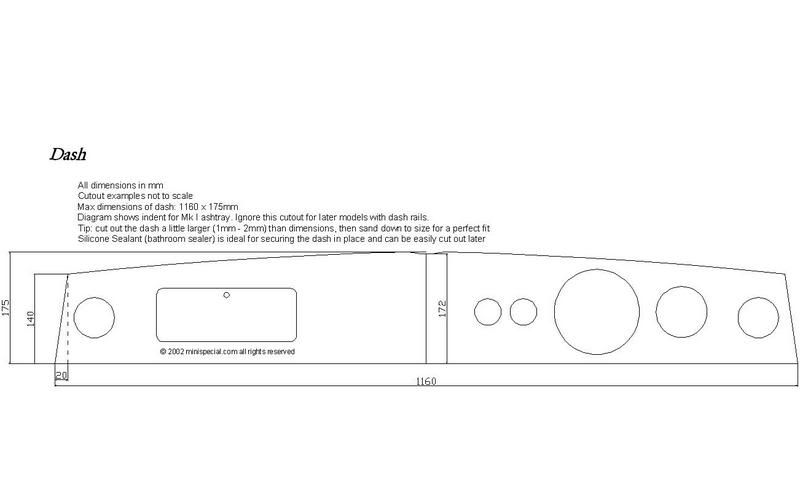

maybe this will help

here's another template

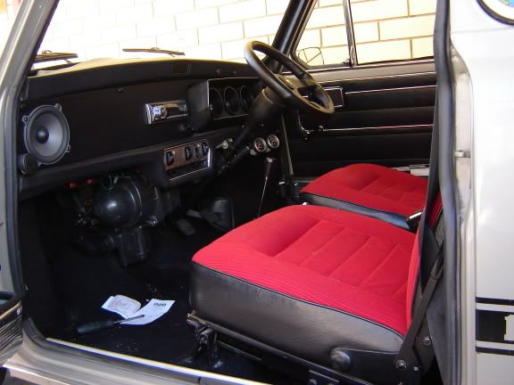

Mine in my (now sold) LS:

Nice dash by the way, very slick looking. Now feeling a little less like posting pics of mine!

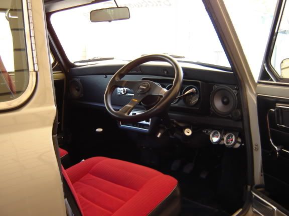

Mines a little different again, no visible screws of any kind, except glove box hinges, which is too late to 'fix'. But yeah mounts great into an aluminium bar across the bottem, which i reckon looks rather cool, and cant move forward due to being mounted behine the rover dash top thing, instead of the common flush mounting, which also looks good too. Mine is secure, doesn't move or shake and can be removed, takes a bit of effort but not too hard, but for the no-screw look things have to be done a little different.
