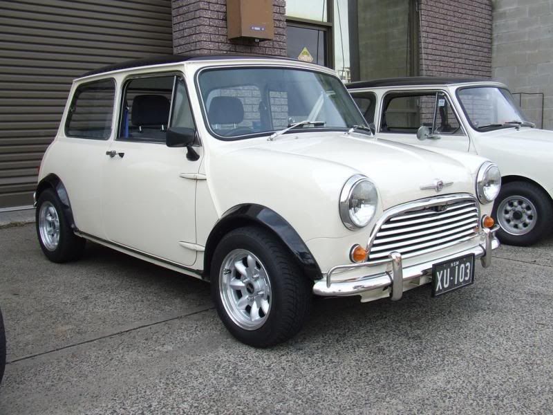

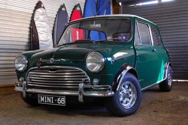

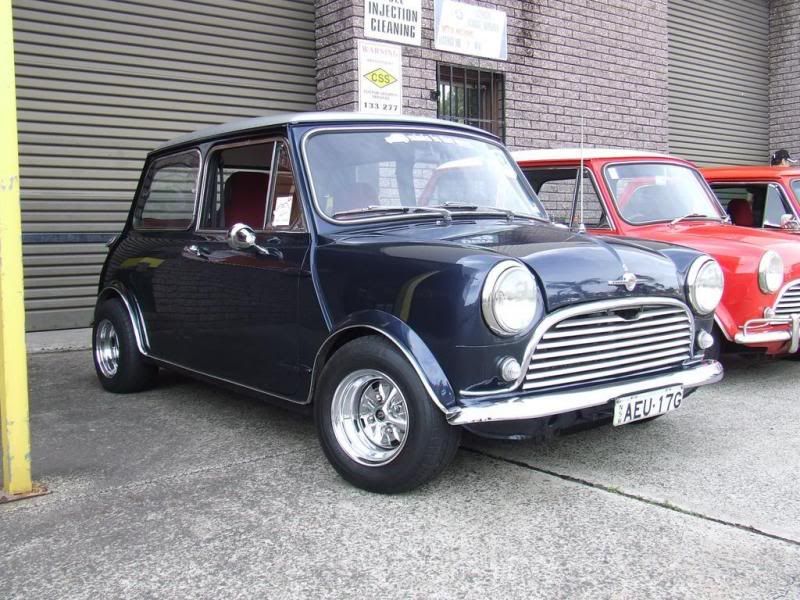

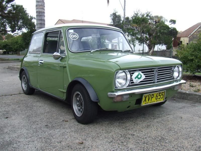

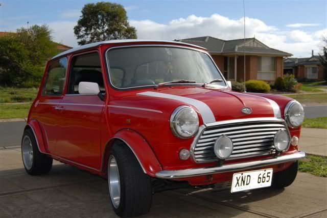

I'm thinking of putting together a "Identifying Flares - How Too" because all too often this topic comes up.
I'm after pictures of different types of flares, what they are called and what cars they will fit with what mods. I'd prefer if the picture is of the flare on the car.
Fire away!

Std Roundnose flare
Inocenti - Fitted to a Roundnose
Inocenti - Fitted to a Clubman
Wood and Picket
Unknown

The one at the top is actually an extra wide factory flare. These were about an inch wider than standard.
The next ones down are Inocenti ones, but they are for a round nose (even though they are fitted to a clubbie here).
The last ones also look like Inocenti ones correctly fitted to a roundie.

The one at the top is definitely not a wide one. It is my car.

the black "uknown" on cream car = wood and picket
the group 2 on the cooper S are mk2 Cooper S flares are they not?
group 2 look nothing like that...

so what are we calling these ones?

PostPosted: Wed Jan 13, 2010 11:34 pm
Posts: 2276
Mine are the same as this and I was told by a mini specialist they were "group 2's". I was told by a previous owner they were a factory flare purchased from BMC but I'm not sure if thats correct.
They are the same design and (apparently) contact the same area of the body as the standard flare.
The extra width means they will cover a 6in wide wheel better.

Posts: 2690
That is what I had always believed, but according to others this is not the case......hmmmmm
does anyone know if they are still available? I'd love a set.

I have a set one new backing plates for both the standard and wide factory flares.
The standard front ones have a 30 mm width backing plate (measured at the top of the wheel arch).
The Factory ST 'extra wide' ones are 60 mm measured at the same point.
