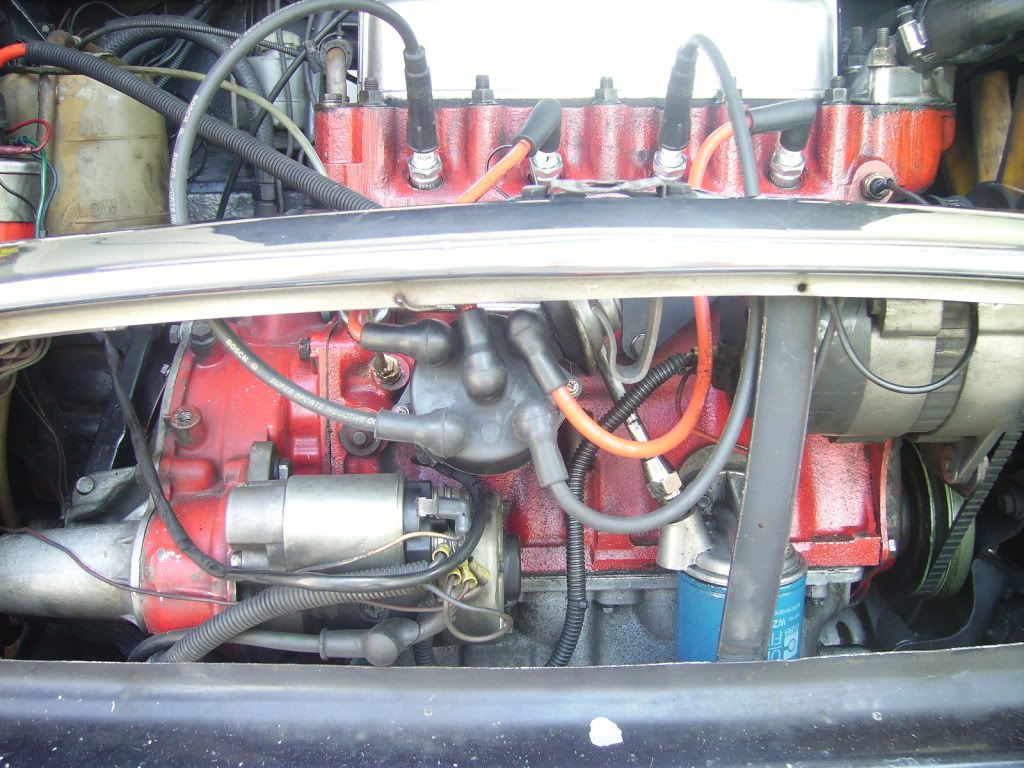

After playing around with Marcia for a while i took a number of things off Morris to get Marcia started. Now to get Morris back on the road I have found something strange. Dizzy is in the same position as it was before (Marked in two places) and have positioned the HT leads in the correct and a number of differant positions including 180 degrees but she only like 1243
Funny enough I looked at a previous photo of His set up with GR HT leads and it seams thats how it has been set up before
Whats the go

Ill also not the position of the Vacume advance
PostPosted: Sun Oct 31, 2010 4:13 pm
You're not reading it the right direction I think. Read the leads anti-clockwise as you look at them from the front and they seem fine.
Vacuum points as it should as well.
PostPosted: Sun Oct 31, 2010 4:19 pm
It's 1-3-4-2 anticlockwise as Mick said.
You can turn the dizzy 90° and move the leads around 90° too, if you like that better.
PostPosted: Sun Oct 31, 2010 5:02 pm
And I don't know why I still have this clockwise idea in my head after I said to you the other day.
I even wrote down each sequences 90/180/270 degrees and didn't think to read them backwards
1243
2431
4312
3124
Now turn Dizzy around 90 degrees as per above and she's spot on again
