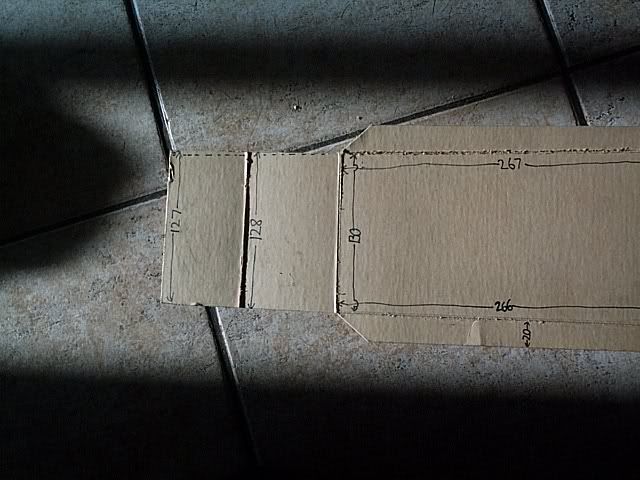

PostPosted: Sat Apr 30, 2005 3:48 pm
Posts: 1285
Location: the Cold Toast QLD
might be easier to post this here.. then anyone else can have there say too.. i actually went out to the garage b4 and stuck this card into the pocket and its a snug fit, also its non symetrical so the other side will be the same but upside down..
will add some text to explain that which i wrote crapily or is a bit odd...

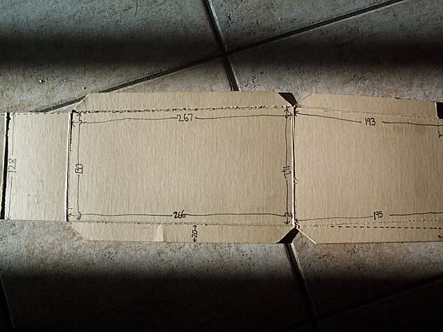

PostPosted: Sat Apr 30, 2005 3:56 pm
Posts: 1285
ok all measurements in millimeters.... no time for imperial stuff LOL
the width at the hinge line to the astray top is 120 and the ashtray top is 88 long at its longest part which is 45 from the face as shown..
you will also see i have continued the hinge line form the bottom sections flap on into the upright bit by use of a dotted line, the gap between the ashtray hinge and where the dotted line would end up is 11

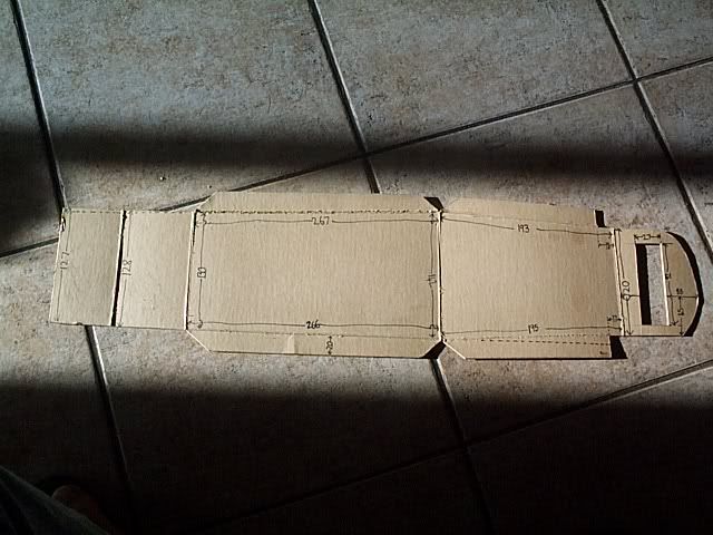

PostPosted: Sat Apr 30, 2005 4:02 pm
Posts: 1285
ok noticed i didnt give a measure from the ashtray hinge to the ashtray hole...
its not square on this pattern ..its 21 at the bottom and 24 at the top
noting that what im calling the ashtray hinge is the cut/fold that is the bend..
PostPosted: Sat Apr 30, 2005 4:10 pm
Posts: 1285
btw all measurements are along the actual cut/fold lines...
this may make the explaination about continuing the bottoms fold line along with a dotted line... its probably more acurate than using a protractor and giving an angle, then you trying to duplicate it..
there is also another dotted line continuing the opposite sides cut/fold line into the bit that comes up the rear wheel arch..the distance of 4.5 offset between the dotted line, and the edge..youll see that in the last pic.

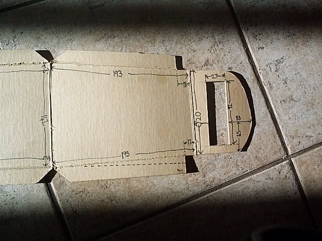

PostPosted: Sat Apr 30, 2005 4:20 pm
Posts: 1285
last of these exciting pics.LOL....
the lower edge is straight inline with the cut/fold line on the bottom section..the 4.5 is at the end of the dotted line at the end of the template..
not too sure why it has that foldy bit at the end.. but if you make one like this it will fit well, snug without rattling and will be pretty dam close to right.. you may want to fine tune it a little but its a good starting point..
it posibly could be improved around the ashtray flat if anything...
good luck let us know how you get on..
