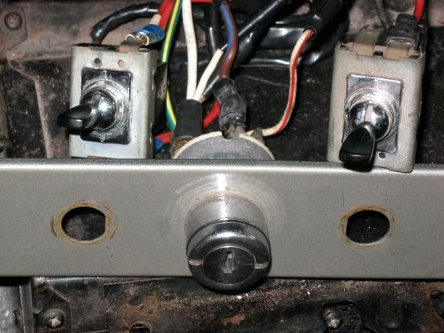

No problem I'll swap them around. But on pulling them apart I realised the switch bases have a flat side that prevents them being the other way around in the metal panel. They would both end up upside down if I swapped them.

winabbey wrote:
Has the switch panel been installed upside down at some stage?
It would make no difference (see pic). Also the key is the right way around and also the heater and choke holes are angled slightly so they come out straight.
