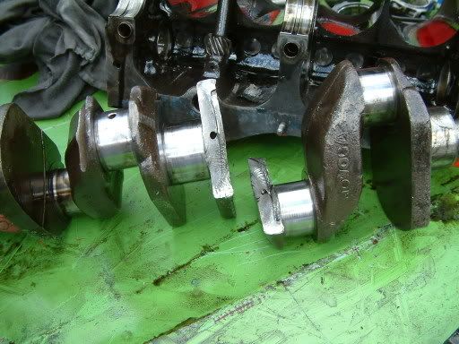

Well, Who had their money on it being a broken crank??
Step up and collect!!
Now hand it over - I need it to buy a new crank!!!!!!
Seriously, I need a large journal 1100s Crank - If anyone has one they can spare or knows where I can get one without having to trade in my First Born, that'd be great.
Anyways, Here's some piccies of the carnage I uncovered today:-
Spot the problem??
Well here it is completely out:-

I bet that radius in the corner of #2 rod journal wasn't right- that's where it started from.
Looks just like Gareth_1330's did... :cry:
When you find one- crack test it before grinding.
The last 5 of these Spiro at St George Crankshafts got to do, 3 were cracked already...

Few ways to do a crack test:
Simple way:
Stand crank on end, strike top crankweb sharply with a 1/2" spanner or similar. It should ring like a bell. "ding........."
If it doesn't, it's cracked... :cry:
This test is not a joke- both GR and Spiro the crank man use it.
Other methods... magnaflux, X-ray, dyecheck.. cost $$, & will show where the crack is too- but that's small comfort. :cry:

PostPosted: Mon Aug 15, 2005 11:01 pm
Posts: 39757
czerial wrote:
OH MY GOD
How does something like this happen????
Pretty easily. Usual cause is imperfect radius put in the corners when crank was ground or reground. Creates a good stress raiser there- in time, with spirited driving, it fatigues and goes bang! :cry:
ok Doc so you know who built my motor. Is this something that he (IMO The best engine builder for mini's in the whole friggen world) can make less likeelly to occur? like would that have happened due to some bad workmanship? or is it something that is not really preventable? Do i need to be more gentle on my little girl? it was lightened and balanced..does that make a difference?

Chris if GR built it, Spiro would have ground the crank. He does nice work, so don't worry too much... :wink:

I was always told 1100s had a predisposition to such injuries but I never really believed it would happen.
Did this do any other damage to the engine/gearbox?
It looks from the 1st photo that it held together okay. Might not have been so lucky if it had been a conrod as you first suspected.
