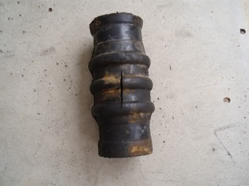

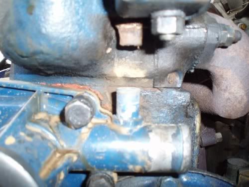

Well, I just finished taking out the cooling system and let me say it's a pretty ordinary task. Not much room to get the bottom hose off. I tried to get the radiator out with out taking out the fan, but got worried about damaging the radiator fins. Any way this bit is split. Can I replace it with a bit of hose or do I need the exact part?
Here's where it goes, between the thermostat and the water pump

I prefer to use straight heater hose.
I have also used garden hose! 8)

Fitting the ones you can get from mini places with the accordian style hose + big strong clamps is near impossible without pulling the engine out or unbolting stuff.
I used heater hose of suitable with and 2 metal screw ties when mine burst on the moke, total cost <$10. Heater hose from Repco, ties from Bunnings. I used a fair bit of Vasoline to slide the heater hose over the top first then the bottom (tried for like 2 hrs before thinking of this).

i've heard the accordian type are pretty hopeless, use the stright reinforced heaterpipe stuff. (not sure if can put straight stuff on with head still on though - if not use the accrdinan one until oneday when head comes off.)

You don't need to take the head off. :shock:
You take the water pump off. :D
The accordian hose is rubbish, it was made to be a quick fix. The factory fitted straight hose.

Yes they did on the Cooper S and later, but the early 850s etc used the accordion one I'm sure. They inherited it from the Mighty Morris Minor... :wink:

I repaired it this morning got the OEM hose and clamps for 9 bucks. I also changed the fan belt, put it all back together and went for a drive. It appears the fan belt is too loose. What's the quick/easy way to pull it off or adjust it? I already know the hard/long way to do it.
