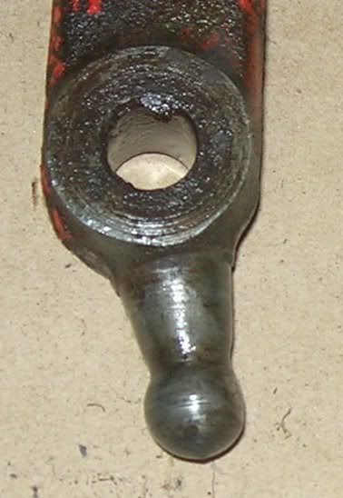

My clutch was dragging and it got to the stage where I had trouble putting the car into gear. I bled the clutch hydraulics. There was some air. Once bled, I could select gear, but there was a little bit of drag. Four weeks later the aforementioned situation happened again. I bed the clutch again, there was some air bubbles, however this time, once bled I could NOT select gear at all, even with the clutch pedal flat to the floor.
Check 1
Checked the clutch pedal clevis and pin. There is some slack, pehaps 1 inch worth of pedal travel.
Check 2
I clamped the hose between the clutch MC and the SC and pressed the pedal and it was rock hard, suggesting the MC and hose are ok, but the SC might not be functioning at 100%. (Thanks to Simon K for his help)
Check 3

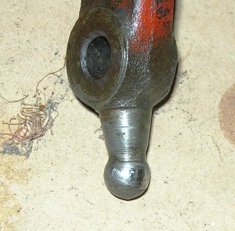

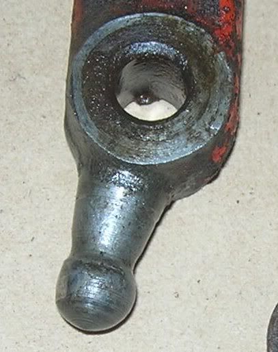

I removed the clutch lever arm and checked the ball at the end. The ball is worn flat on one side, the contact side. This can be seen in the photos shown below. The contact surface is very highly polished.
My question
Is this wear on the clutch lever arm sufficient to cause the problem of severe clutch drag and trouble selecting gear or is it "within tolerances"? :?

It's well knackered, the cause of your problems- toss it and buy a new one.
Also check for wear in the plunger it goes into, if grooved go find another. :wink:
Grease it good on assembly.

well you might be able to hardface it, but it's doubtful it will then last without the little arm bending as you will anneal it in the process.
I got one professionally TIG welded back together by Cigweld once, when the little arm bit broke right off, and it only survived 3 months.
Not worth the hassle IMO. New ones are not rare, or dear either.:wink:

I would suggest the damage is not tooo bad. However, check out the release bearing shuttle. It also wears and the combination wear patterns can do strange things.
I have had symptoms such as those described - but found the ball had broken off the clutch arm completely.
I think I would be looking elsewhere for the problem as I don't think a simple arm replacement will solve your woes.
Cheers, Ian

But sometimes you have to understand what you're reading.....
The wear MC describes is between the clutch pedal and the the master cylinder push rod.
The wear shown in your photo is easilly adjusted out using the clutch adjuster bolt. When it gets much worse people resort to bent lever arms. What's the inside of the release bearing shuttle look like?
I just wouldn't want you to be too disappointed when the new lever doesn't do much (you have checked the adjuster bolt haven't you?).

Often the plunger wears nearly as much as the ball does. The wear shown in your photo (if combined with a groove in the plunger) means the lever can run out of travel in the hole and will then jam in the plunger, before full movement is reached.
I had that problem once, and the ball wasn't worn as bad as yours (but it did bend the lever end).

This is true Kev, however, I've had a ball break off a lever - but the clutch still worked....
I still reckon if he races out and gets a new lever things won't be much better. The wear on the ball alone is not enough to cause the reported symptoms...

Will the clutch lever arm over extend because the ball is worn and if so will this damage the SC cup seal ?
