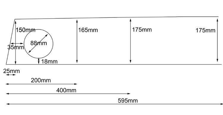

Just wondering if anyone has some measurments I can go by.
Im making my own dash and i have bought all the materials, just need to mark out the shape and get cutting. (all dash paddings have been removed so im not sure where to measure :? )
so can anyone help me out?
any help would be greatly appreciated.

where abouts in melb are you? I think minitopia in fawkner might have a template there you could copy... otherwise, do a search on the ner... I found a good one a while ago.

Check the mini mania website. I think they had some dash template's on there. I think I found it once by searching ausmini.
Keep in mind that all mini's are built differently - so leave a bit of extra meat around the edges incase it doesn't quite fit.

http://www.ausmini.com/forums/viewtopic.php?t=22390&highlight=dash+template
Razor from that thread wrote:
maybe this will help
Obviously the other side is a mirror reversal of this side.

Cheers mate.
trixitrine Im not far from Minitopia.. I saw your car while you were airbrushing it :lol: haha

Um, there used to be one on http://www.minifinity.com but they've gone and changed the site to a blog style with a new forum and I can't find the templates/measurements anymore (used to be in Tech Help Library I think)
Edit: Dagnamit - took me 5 minutes to search through minifinity and then post this reply and in the meantime the template was already posted!! - That was the one that I used, even though i only made mine a half-dash cos i didn't want to dismantle the cluster.

Hi clubby 757, I have the measurements for my dash if you like
PM Me if you would like them.
James

When I made my dash, I compared a couple of templates that I found (the one above was one of them, and it's the crap one if i remember correctly) and they can differ by quite a bit.
Anyway, I used the bigger one of what I found as a starter, and trimmed it from there.
I used 8mm MDF, but next time I'd use 10.

I pull MDF out of mine, if your mini leaks like mine does the MDF can swell up and all that hard work can be ruined :cry:

Years ago when I made one for the 850, I used 1/4" marine ply. :wink:
Much better than that `MDF" pre-digested woodpulp... bends better too.
