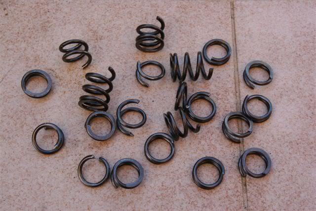

Coil bind can be a SEVERE problem. I've only just repaired my new motor this week.
This happened after only a few thousand kms:
Obviously this is what you are aiming to avoid!
They have been replaced with standard "S" inners - had no problems with the outers. All 4 intake & 2 exhaust springs were broken.
This is an extreme combination of big valves, 1.5 roller rockers and a Kent MD296SC cam. Al Munday ended out pocketing the head for me to get the required clearance, as it was already running without inner spring retainers.
Now running with 20 thou tappet clearance too.
Boy thats a Nasty result !
