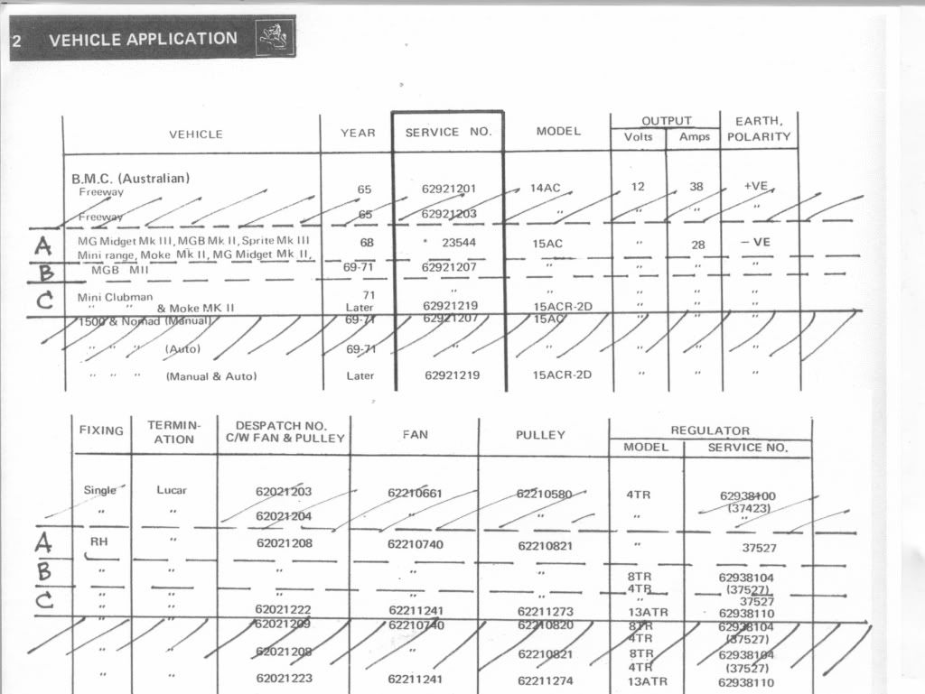

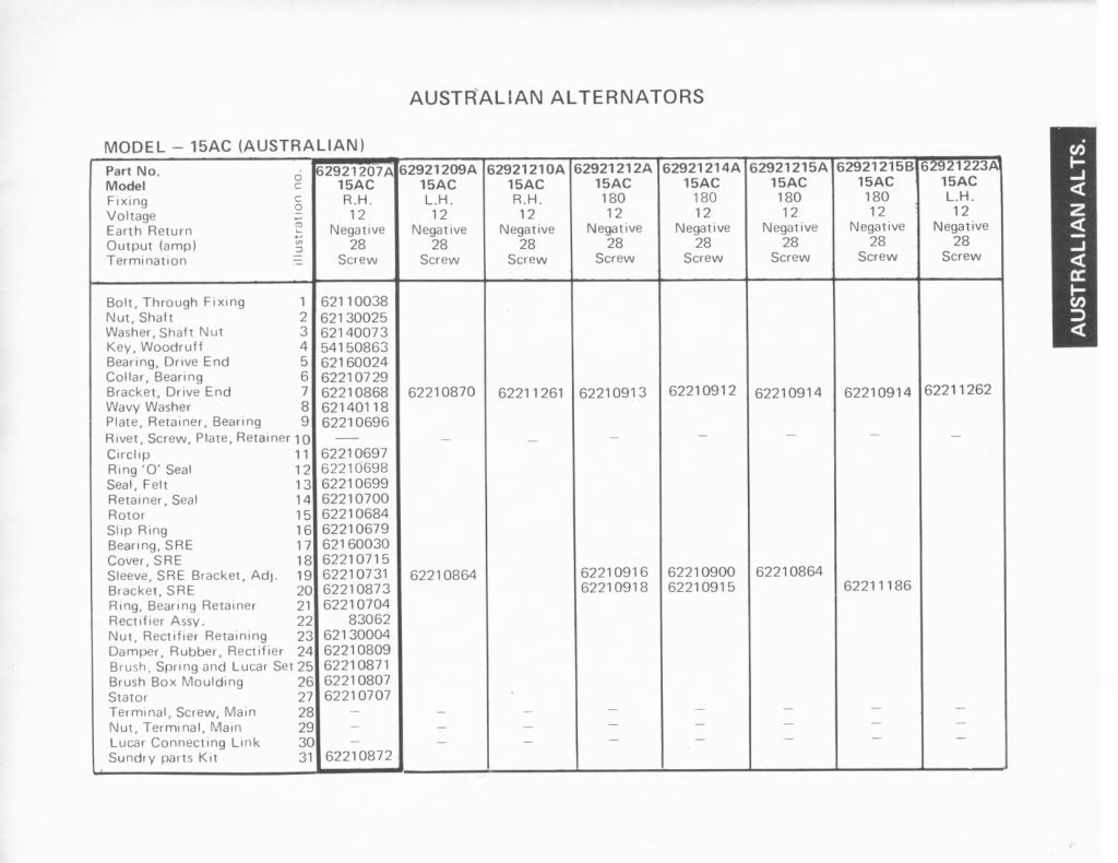

PostPosted: Mon Oct 27, 2008 4:53 pm
Posts: 6751
The BLMC Mini Parts Book (PUB 1056M) for the MK II Series makes no mention of an alternator, only a generator, so it's inaccurate.
The Clubman Parts Book (PUB 1052) shows the 15AC alternator (part # 62921207) and 4TR regulator (part # 37527).
Below are selected pages from the 1972 Lucas Australia Alternator Manual. The first image is from two adjacent pages so you need to mentally line them up. The lines marked 'A' are for the Mini range and show a year of 1968 for the alternator introduction and 4TR regulator. The 'C' lines are for the Clubman range which show a 15AC initially and then the 15ACR (with inbuilt regulator) for later models.
The only mention of 8TR regulator is for the MGB MK II.
I've left the images bigger than normal so they are readable.
