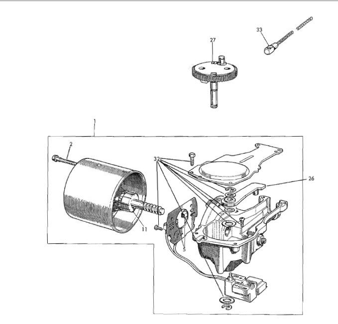

So Doc which part is it in this diagram from the parts catalogue, as thats what mine looked like when i dismantled it. Is it attached to part 27??
also what else should i replace

PostPosted: Sat Feb 07, 2009 5:23 pm
The Mini King
Posts: 1338
Location: Windsor, NSW
This is a drawing of a Uk wiper motor, The park system works differently to the Aust Model, However the Park plate On the Aust Model is Located under No 27 in your drawing, Other than the park plate Check the contatcs that run on the park plate, You will find these are conected to the splade conectors located in the little plastic piece at the rear of the wiper motor, Also check the brushes And comutator, The last two items do not tend to be a big problem on this Model Wiper Motor However

I found where the plate is :lol: :lol: :lol: It was covered in grease
Thanks for the info John, that diagram i got from the parts manual containing YG2S6,7&8. Yeah that manual has a lot of Brittish stuff, i didnt know there was a difference between aussie and brittish but it should still help me with reassembly i think.
