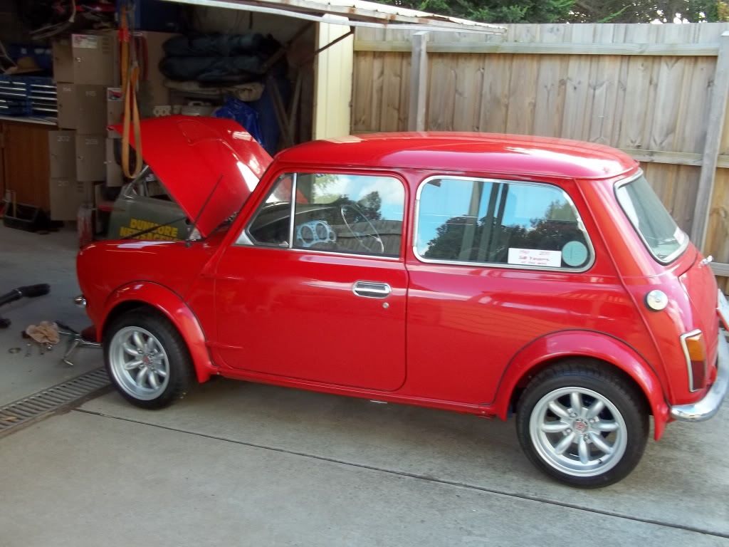

I had an issue with my engineer concerning my 13x7 wheels
Harley is correct about the track issue ,you must not alter the track
more than 25mm 13x7's are legal depending on the dish
Ihad 13x7 deep dish superlites and although my engineer agreed they
looked awesome they where over track
I then bought some SONIC 13x7's which have a shallower dish but are still 13x7, they dont look as good but are within the legal track specs
Cheers Hallsey
PostPosted: Mon Jun 13, 2011 6:44 pm
Posts: 3166
Nice car Hallsey

Nice car Hallsey
...Very nice car!
