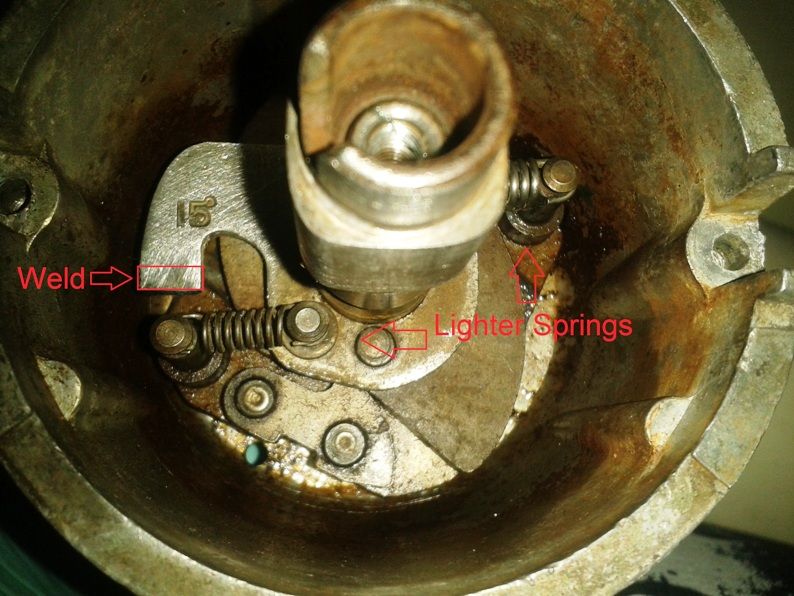

MK1 S 23D4 and the MK2 S 29D no vac internally are very similar and have the same slow advance curve and a 15deg advance plate inside the dissy. The total crankshaft advance is 30deg. If you set your static advance any more than around 6 degrees you may get pinging. There is a simple mod if your handy with a welder and have an accurate timing light. Or do what everone else is doing now and go the black box.
Here is a picture of what I did to mod my 23D4 dissy. Easy to pull apart. Just punch out the drive cog pin and the rest comes out the top.
Check for bush for wear which will change the point gap and the dwell.
