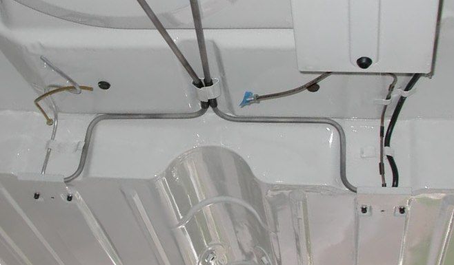

Just trying to clean up a few items on my car back to original. I must admit I haven't really taken much notice of the battery cable routing in the past.
I have only recently noticed that my battery cable doesn't run up over the subframe like my clubby did. It is P clipped underneath at a sharp angle.
It may have been replaced in the past and it was too hard for the previous owner to re-route over the subframe in situ.
What is the correct way they routed the battery cable on a 68/69 Cooper S?
If it is supposed to go between the body and frame, and can this be done in situ or will I need to pull the subframe?
This is what it looks like.
This is what it may need to look like.

Did mine recently on a deluxe. It is routed behind the subframe which I'm guessing is correct. Can be done with the subframe insitu. This way the subframe can be removed without removing the cable.

The photo of your battery cable route is the same as my K and S. Does not go behind subframe like hydro and brake lines, but loops under it with that P clip, disappears into skid plate exactly the same as yours.
That should be 1 less thing to "change".
Bill

Yes, looks amateurish. Maybe your cable could have a little more slack in it to get a better curve.
The original battery clamp on (+) terminal was sweated on and couldn't be pulled through hole, but it was made of lead and gradually lost shape. I have removed the lead clamp and soldered the wire strands together and use a brass terminal that has a pinch bolt to attach to the cable so that the cable can be pulled out through the hole in the floor if necessary. Am just about to do this job on my 'project'.

You will find that the Battery cable gets routed under the Sub Frame most times because it has been shortened. people do that to gain some length. Not a very good practice like you see because of so many sharp edges. Usually when I get a Mini with the battery cable that has become too short I terminate the cable with a soldered lug on a Proper Battery cable post which I mount on the side of the Sub Frame and then have another short cable from there to the Battery terminal. This makes it easy to replace the cable again if it ever gets short again.

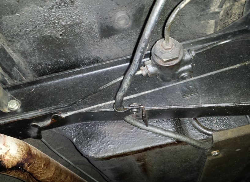

This is how it's routed on my MK II S.

Thanks Doug. Looks exactly the same as mine. Can i trouble you for a photo of the battery cable clamps?
