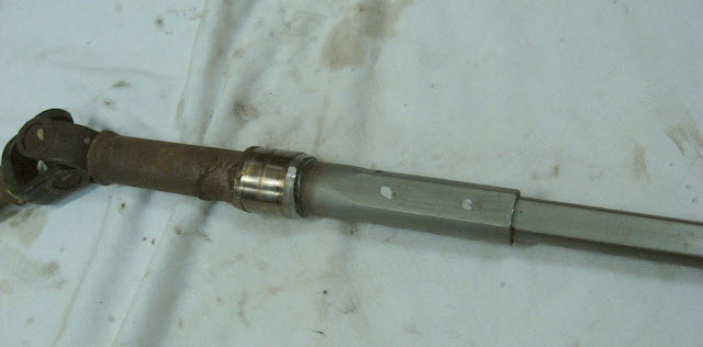

The next step was to join the two lower uni joints. Luckily there was no need to shorten the entire column so this was a simple task of cutting off the splined shaft on the Daihatsu uni joint (right hand joint in photo below), slightly shortening the splined shaft at the bottom of the Starlet column and machining an adapter/coupling to join the two, then welding together.

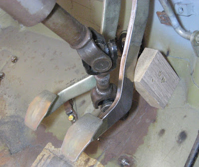

I also found that the brake pedal fouled against the uni-joint so I had to modify the bottom part of it so that the bend was further up the pedal than the factory. The pad position was retained in the same spot as factory.
