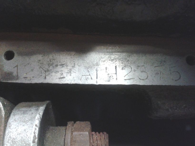

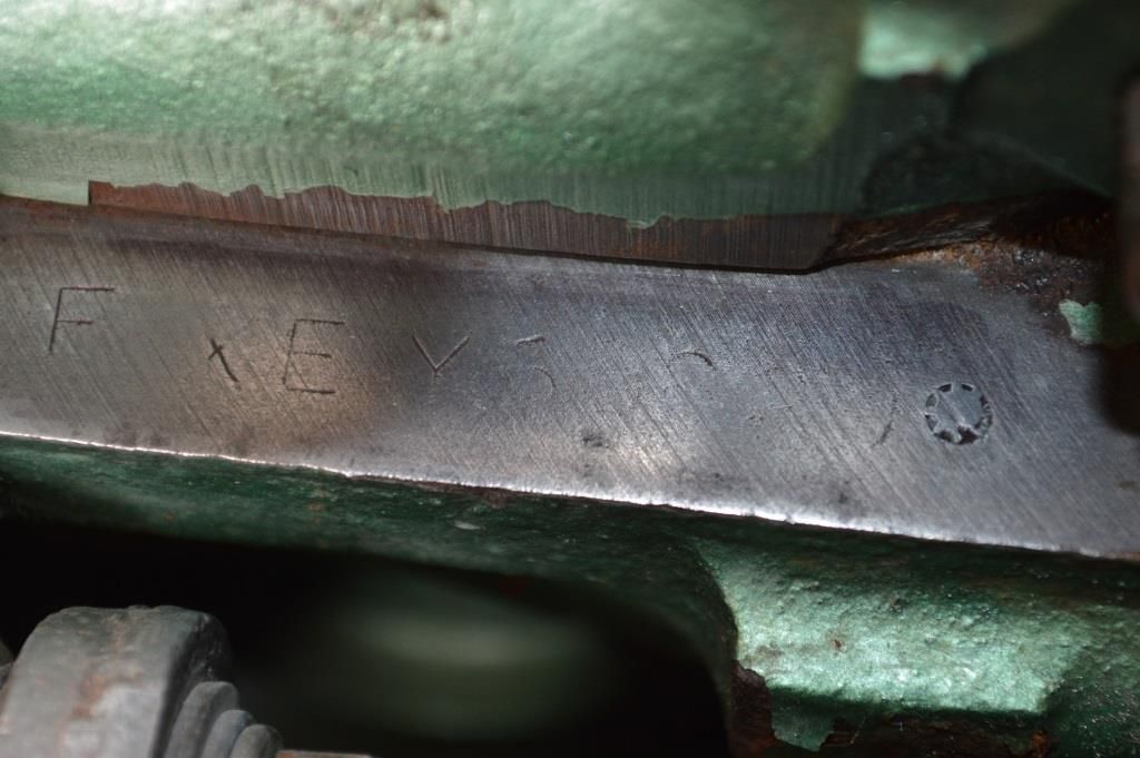

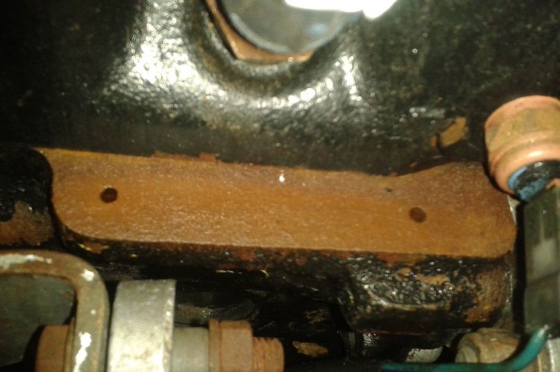

Here are my before and after photos but I think my issue was more rust than machining.

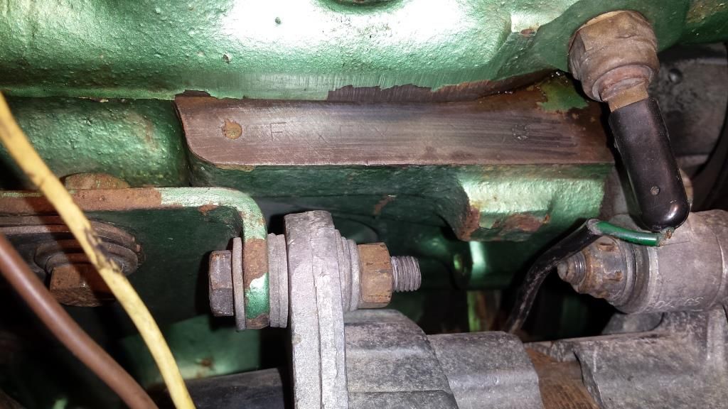

Thanks for the tips everyone-the best result has come from a black texta and steel wool.
If you squint and look out of one eye you can almost see the numbers!! (it's meant to be 55629)
