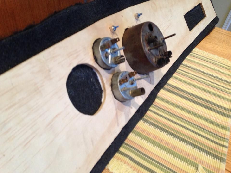

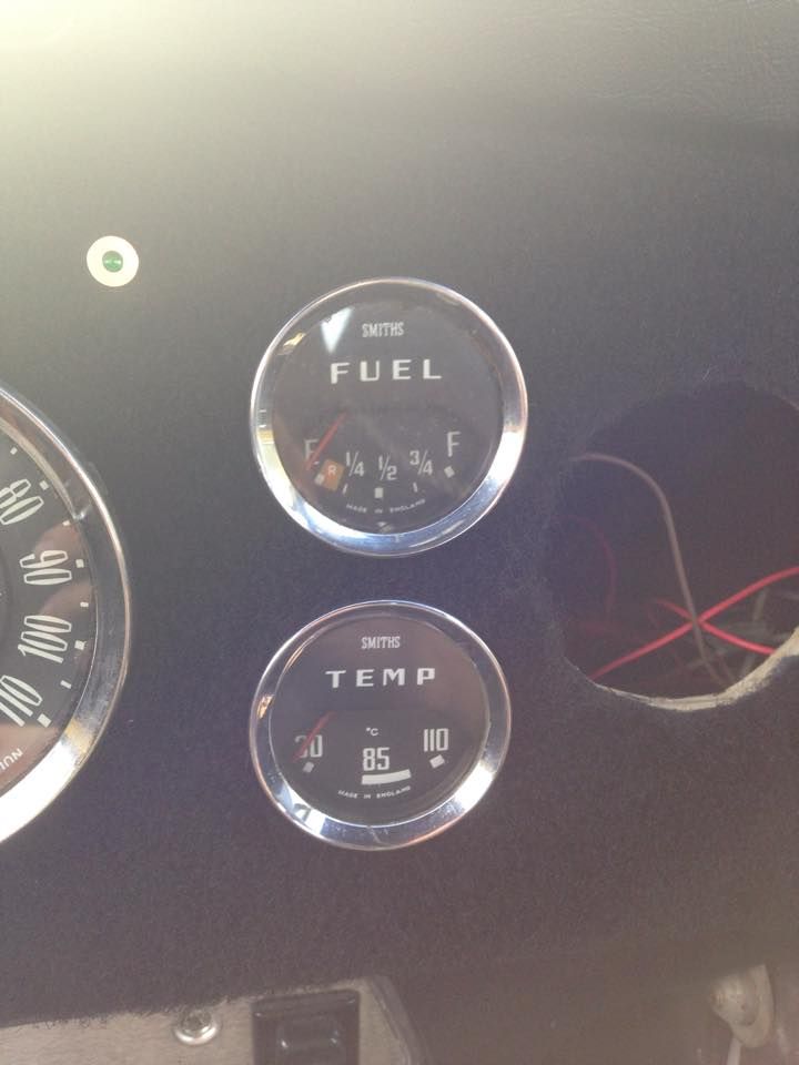

Now it's all made up and looking pretty I need to wire all my guages up. the speedo I've got no worries with and everything there works fine. I'm having trouble wiring the fuel and temp guages however. These are genuine smiths gauges I bought off ebay for a good price. I know the wiring is all there in both of them as in my fiddling around i've got the needle to bounce from side to side with 12V added.
I've not been able to get either of them to work once I've wired them up and am not sure how that even is supposed to be done. I know I've got the right sensor wires as I looked at the wiring diagram and the curcuit board from the original 2 pod cluster.
I suspect that there is a spade for 12v, sensor wire from the sender and a ground. however, I'm not sure if this is the case as that doesn't seem to be prevailing. I also tried wiring in the voltage regulator from the original cluster but that hasen't helped either.
Who can tell me which spade terminals do what? Sorry about the pictures and I cannot find a wiring diagram of a guage of this era online
there are 2 spade connctors that are conjoined and one that stands alone on both guages

The "sensor" wires will act as the ground and the variable resistance they give is what changes the reading on the meters.
The other connectors will be for power to complete the circuit. The dual connectors will be so you can jump this power between gauges without having to run long feeds for every gauge.
Usually the gauge body will act as a ground for instrument lights - but if using on a wooden dash will have to add an earth wire to somewhere (eg the parcel shelf). I usually run this from the mounting screws.
Hopefully the power to the bulb is self evident.
The gauges may have to run via a voltage stabiliser for accuracy .. but others may be able to clarify / explain that. < Doogie already jumped in...>

Neither of these gauges work with a regulator. They work on 12 volts. B for battery T for transmitter.
They both require a sender 83-3 ohms. Not 250-19 used on the post 1964 bimetal gauges.
You can have the clubman fuel sender rewound to suit. The temp senders for these gauges are no longer made. NOS senders are expensive as a consequence.
All others posts are incorrect I'm afraid. :D

Calibration of the gauges should also be checked. It is very easy to move the two nuts on the back which changes the span and points radically.
