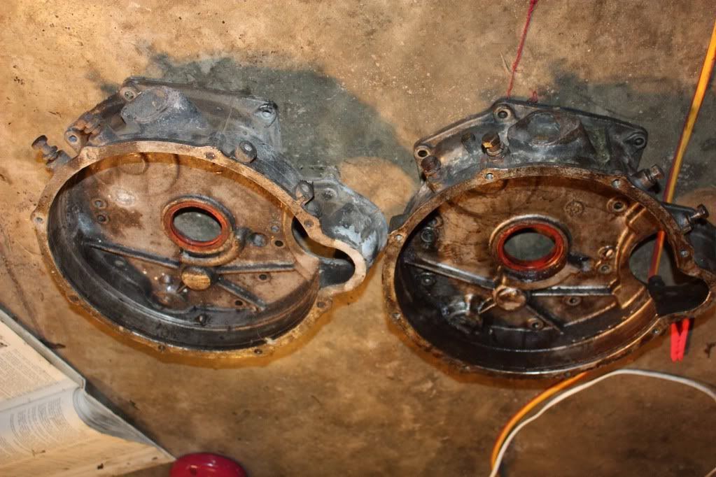

hmmmm.... well this is the fly wheel housing off that gearbox, to me it looks exactly the same.. :? THe one on the left is clubman remote one, and the one on the right is the one that was on my magic wand..

Yeah both those covers ARE the same- if your 850 has a 3 synchro box someone has added that later cover to it. It's used on all 4 syncro boxes including yours, except the later rodchange ones.
