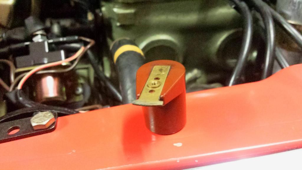

I have machined the s/h 25D6 rotor's counterweight to clear the module, however it is now a loose fit on the shaft from the interrupted cutting, so is nfg.
I will go back to plan A, and solder a little bit of brass to the side of a stock 45D rotor.

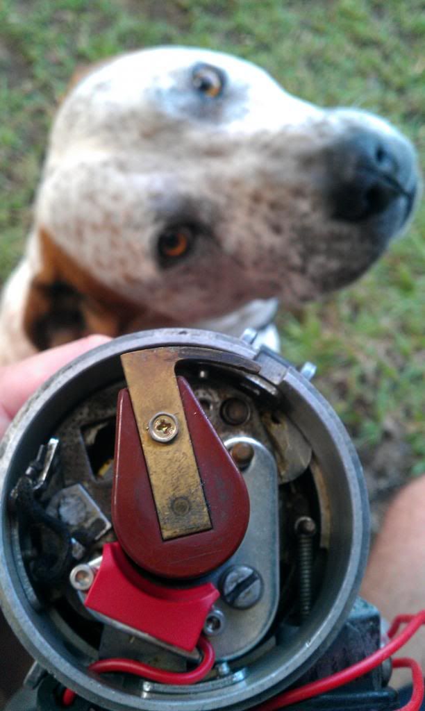

I've just gotten home after 3 weeks away last night, so I've just pulled the 29d rotor button out to have a look.
As I thought it might, the spark pattern is more reasonable as the advance used in my timing map is more like a standard timing pattern for this dizzy. Now with added reliability and flexibility...

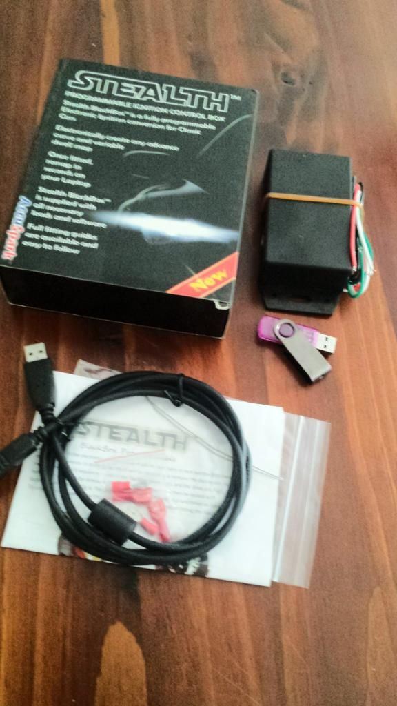

And I bought myself a present while I was away. A second stealth unit for the 62 Cooper :) Seems they now give you a USB instead of the CD. I'll see if I can work out if the software version is the same or not.

Yeah, mine came on USB, software seems the same but I can't get `real time' to work...
I wish they came with a Molex plug on the back to make it easy to remove if needed.
I extended the wires on mine using 7 core trailer wire, I soldered them and used heatshrink. 4 of the colours matched.

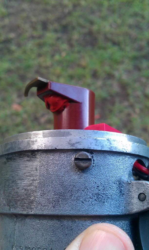

I finally got up to the top shelf in the shed yesterday and located my dizzy with the extended rotor button I used with and electronic ignition module from Jaycar 18 years ago.
As you can see from the photos, I removed the brass section from the rotor and made my own up from some brass sheet I had with the extended trailing arm. Then carefully drilled and anchored with a 4/40 bolt and nut I think, with some high temp red silastic to prevent ant tracking / arcing down below to points at the time. Worked a treat!
I removed the fly weights from down below and advanced the spindle and then locked it off in the fully mechanical advanced position. Similar to what everyone is doing with Accuspark.
Cheers Shane

OK it's now been a week since I physically advanced the dizzy to 10deg static, so I pulled the dizzy cap off for a look.
It is now sparking on 3/4 of the rotor's brass strip, instead of just the leading corner, like it was when set for TDC datum.
So, I'll leave it set this way, running the std 43/45D rotor. It is now going like sh!te off a shovel.. :P 8)
