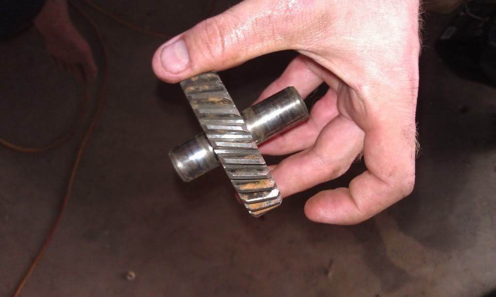

I found this little guy in a box of parts i hadnt really sorted thru properly.
Am i right in saying that this is the 4 syncro type, which makes it worth holding onto ????

Yep it's a 4 synchro, you would need to get the rust off the short shaft end or the needle bearing won't like it. :lol:

Yea, it is all just a bit of surface rust. some already came off with a little brush.
it was sitting in an old ice-cream bucket. :lol: :lol:
