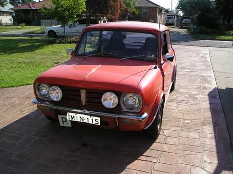

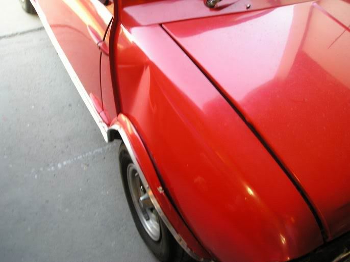

The seams are circled in red
Minis can look good without them (as long as the roof gutter stays on... otherwise it looks like a jellybean - according to poeee) but it weakens the body if they're removed.

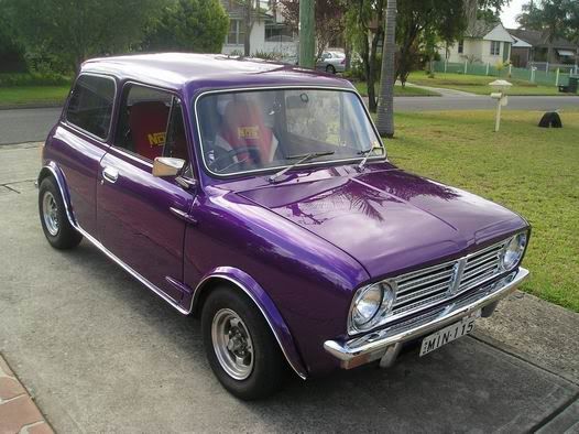

With the seams on

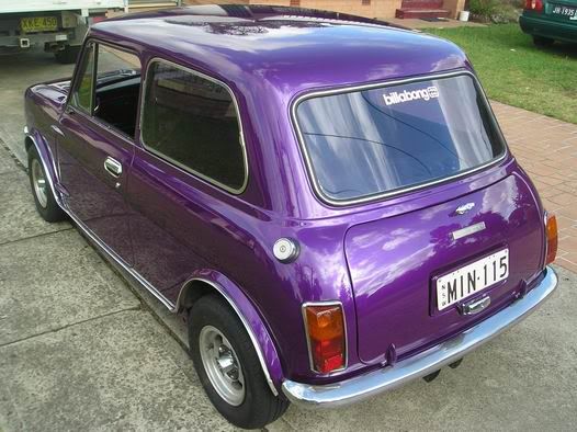

Without (De-Seamed)
Life's a garden.... Dig It!
PostPosted: Tue Jan 24, 2006 5:57 pm
Joined: Mon Jan 09, 2006 6:09 pm
Posts: 98
looks very clean without seems. i'd definately do it if i had the welding skill but alas :(
