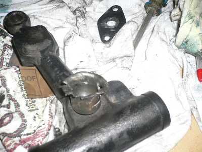

My recently purchased mini "Camilla" was very low at the front so I knew the cones had sagged and the nylon cups were probably shot. I took the passenger front out today and found this:
The alloy trumpet has corroded all the way through from the inside. The nylon cup was shagged too.
This is the inside. Nasty...
The upper arm has obviously been around a lot. The ball must have worn right through the cup at some stage and has worn a spherical hole in the arm. You can see the end of the old cap where it has molded itself to the sperical shape of the arm, which should be conical like the new cup.
I don't know what to do about this. I reckon a new cup will just split because it won't be supported properly. I'll also need hi-los to compensate for the wear. I'm considering using devcon to re-shape the socket in the arm. Put the mixed-up Devcon into the socket and push the new cup in on top to mould the shape. The surplus devcon will just come out the air hole the underside of the arm. Any thoughts?
