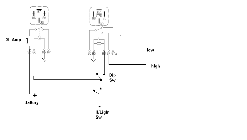

I've nutted out a schematic for anyone interested. With the floor mounted dip switch I moved the High bream wire (blue/white) to the centre terminal and the power in (blue) and the Low Beam (blue/red) to the double terminal (formally high beam) the third terminal is unconnected(formally low beam). To save cutting into the loom there is a connection point at the back of the instrument cluster where the dip switch wires meet the loom and the power from the light switch. - I'm refering to the MK1 layout - other models may differ.

Why the second relay? Not just for the 30 amp fuse is it, cos all you need then is an inline fuse or fuse box terminal?

2nd relay cause you are switching a high current with low as well as high and the old Lucas switches get weak at the knees. This way you are only switching in the coils of the relays at a very small current and letting the contacts in the relays cope with the arc like they are designed to do.

I have just two single pole relays. The switch provides 12 volts to the dip switch, which then fires up the h/b or l/b relay.
Same result, just two of the same relays.

I have had my H4's for well over 25yrs and they have been in at least 6 cars without a problem why do I need a relay?
PostPosted: Tue Mar 20, 2007 4:54 pm
To make your switch last longer & reduce the chanceof letting the smoke out of the existing wiring loom
PostPosted: Tue Mar 20, 2007 5:01 pm
Posts: 4031
Made mine brighter too. I had some dodgyness going on about the place (when is lucas not dodgy?) but with relays it all works better.
