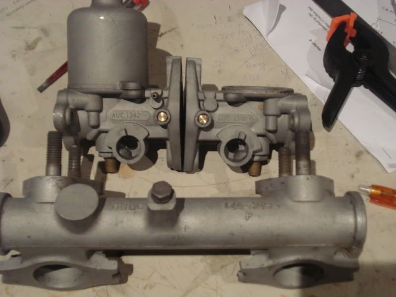

This is the cooper carbs I have here. 12A-309 on the manifold, AUC 1341 (and a small 7)and AUC 1342 (and a small 11).
The float bowls have AUD 99R and AUD99L tags, but I am not sure if they are the correct numbers for a Cooper float bowl tag.

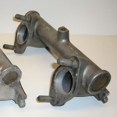

If you are looking for a manifold be careful about just going by the number, I've seen 3 different types now, all numbered as 12A309P.
1/ As pictured but without the undrilled vacuum takeoff boss (I think I have a spare of this type)
2/ exactly as the one pictured
3/ the type that suits 998 Cooper, has recess for locating rings on head mounting face and the "lugs" that locate on the mounting studs are removed as the locating rings do this job
Steve

I think the right one for 997 is like the one in pic but without the undrilled vacuum boss.
see here for exhaustive chart etc on these manifolds-
http://www.minimania.com/web/threadid/8 ... thread.cfm

Thx Doc , that would be this one then below ??

It looks right to me.
graham in aus is the accredited 997 expert though... :lol:

With this in mind then (and not looking to take the thread) would I be right in guessing the manifold pictured is perhaps from a Midget or Sprite?

Thx for the pic willy , looks like the same manifold as in the pic i posted ?? has no provision at all for vaccum take off . What is on the fuel bowl tags and numbers on side of carbs ??
