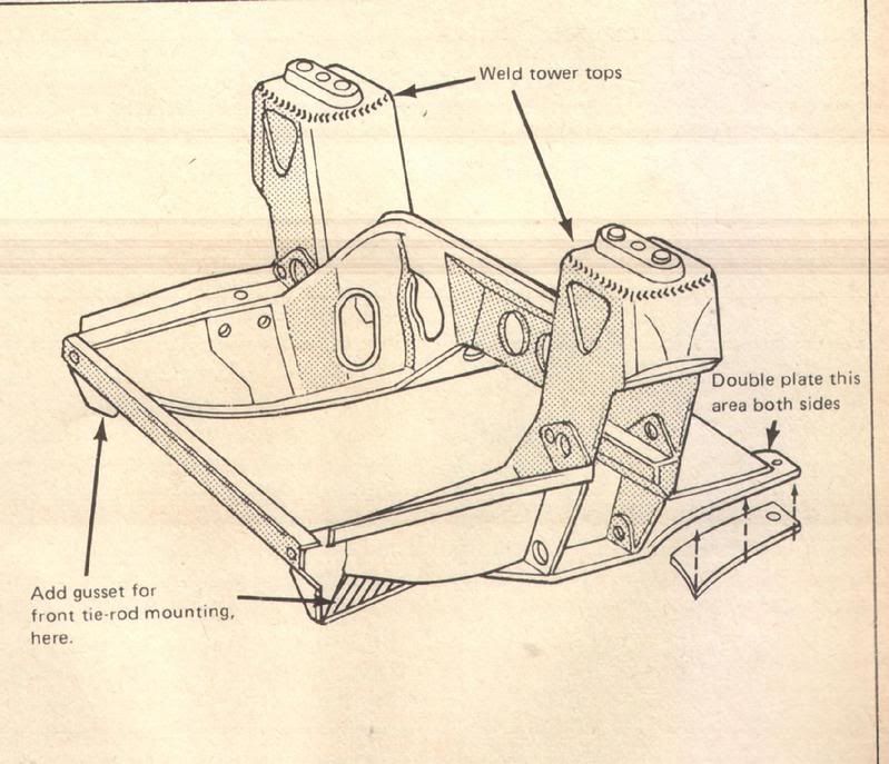

This what you mean Matt - but not full welds around the tops of the towers?

smac wrote:
Matt, any chance of a pic/drawing? I didn't get that description.... :oops:
Ditto :D
Am interested in the bracing for the towers and the diagonal bracing also, any chance of a pic or modifying the pic posted by Wombat??
