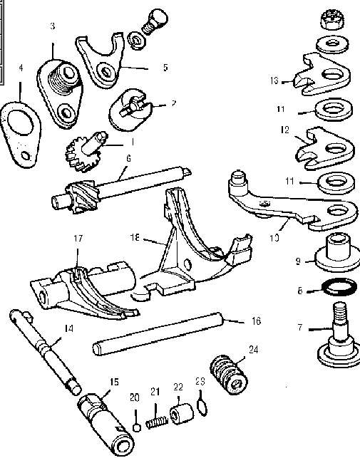

Could it be from the gear selector/bellcrank from the rodchange box? What do the spacers between the bellcrank levers look like? It would be about the right size and it could explain the loss of one gear.
Part 11 in this diagram...
PostPosted: Fri Dec 28, 2007 12:37 pm
Posts: 7673
its a remote change :)
PostPosted: Fri Dec 28, 2007 12:41 pm
Well that screwed that theory! :lol: :lol:
