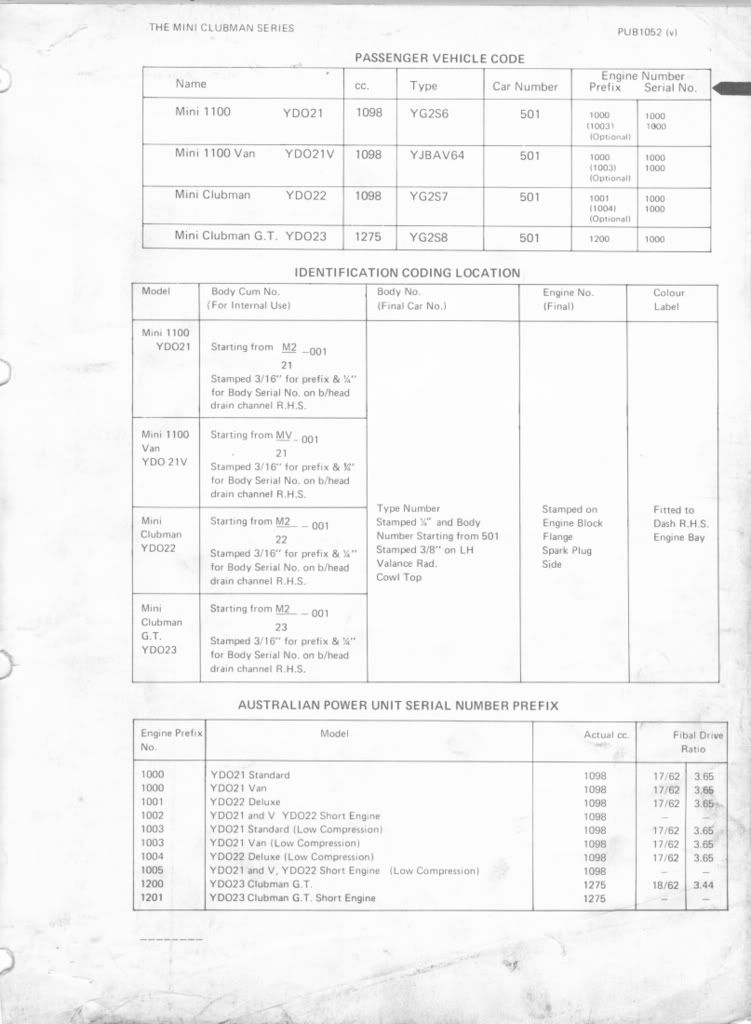

Just posted this on another thread but thought it might also be appropriate here to help identify the car through the body stampings.

Only difference being the early GT Clubmans had Mk II Cooper S engines prior to the 1200 prefix. :)
Hey Julie - I thought the 1200 prefix was also a Mk2 S block just stamped 1200xxx??
PostPosted: Sat Oct 18, 2008 8:53 pm
Posts: 3415
Location: Cowra
Brown Clubman wrote:
9F blocks and 1200 blocks are exactly the same just got stamped with a different number.
I think she means is that the early clubman Gt's had 9f blocks that were left over from cooper s production, then they started on the GT number 1200/xxx
