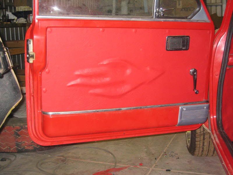

PostPosted: Mon Mar 09, 2009 2:22 am
Posts: 2372

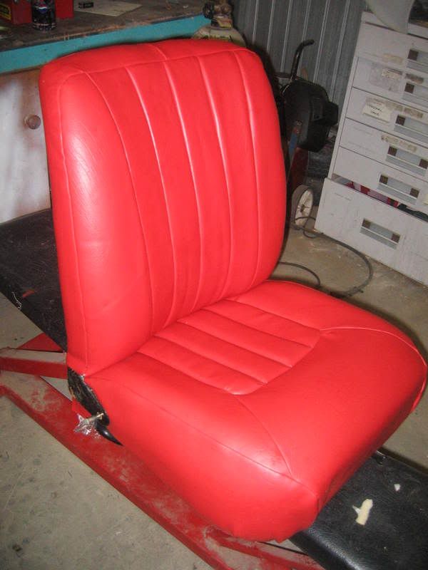

I had a crack at some door skins and my boot and some seats.
I have made covers but havent fitted em to the back seat I have just finished the fronts.
I unpicked an old seat to use the pieces to copy so it was a bit shrunk and stretched in places so it wasnt an ideal template, but it was one non the less.
I put a fair wack of extra foam into it mainly to try and get the seats to "hold" you better. Theres a few wrinkles and creases that I will rub out and retighten tomorrow after they have been in the sun for a while. They are comfy as all hell.
they are clubby ones with no headrests, I have em hear but I like the look without. As long as I dont get smashed up the ass :oops: that often they can stay off.
As far as the boot and the doors are concerned I just "did" it. I didnt really care what I did but they are ok too.
