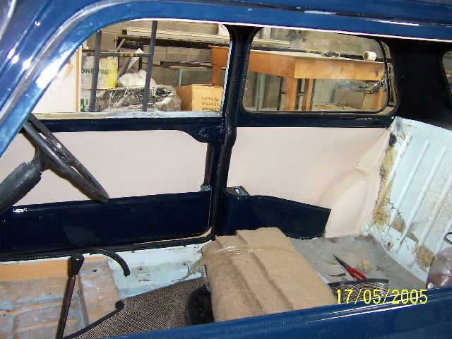

A mate and I did mine whole interior but we used mainly leather
as it was at a good price at the time
He had a bit of background in office furniture which helped
