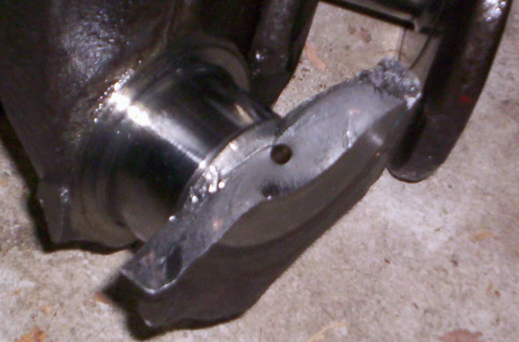

Is the cause of that one in the pic breaking known?

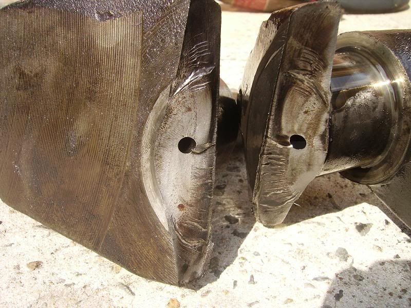

Usually a fatigue crack in a 1098 or 1275 crank starts from one of the big end journal's fillet radii.
It's most important when regrinding them that the radius is kept as big and smooth as possible.
It's a bit hard to tell from that pic but it does look a typical failure.
To improve fatigue life we used to mask up all the journals up then shot peen the crank webs and fillet radii, back in the 70s.

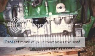

1275 flat chat down back straight, bit undergeared, a bit over revved.
Cross flow ventilated gearbox, new design.

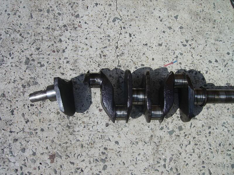

Here is my effort
Since found that it also put a small crack I'm the block .... Grrr another 1275 block

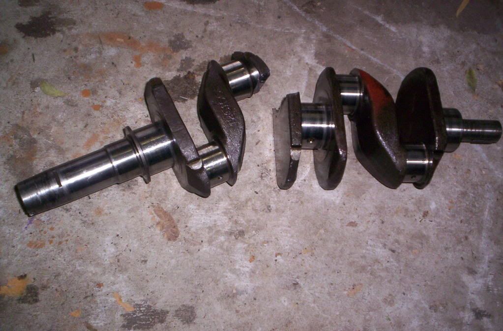

I'v got 1 also

old age... fatigue,,, ecxessive high rev abuse.... poor harminic balncer condition,,, i can go on & on
most crack right through the oil hole & edge of journal (as all the photos are showing) ...on the edge of sharp fillet,,, that`s why newer (less fatigued) cranks with large/broader fillets are far better
