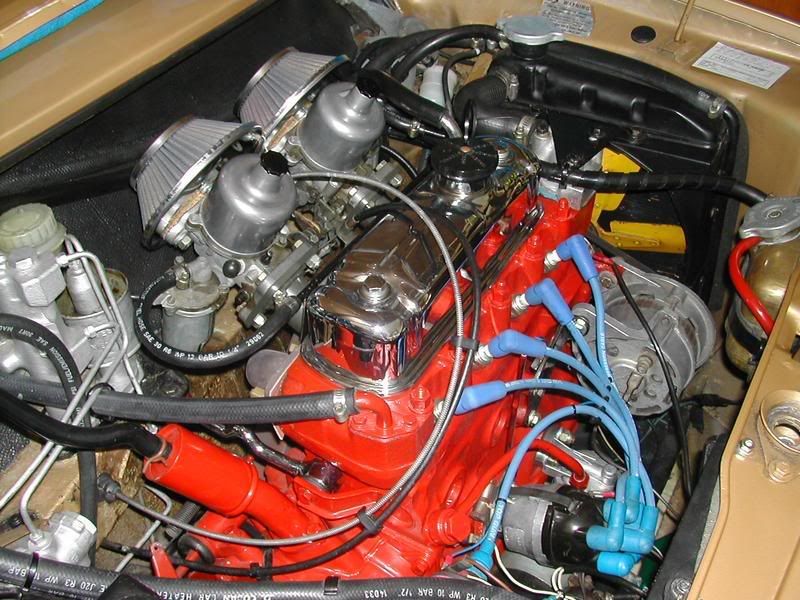

I think you have a Clubman-if so this is how I have the brass tank attached on the LH side-then I also have a Clubman heater core attached on the RH side.
PostPosted: Sat Jan 15, 2011 10:08 pm
Joined: Tue Aug 11, 2009 7:35 pm
Posts: 367
Awesome - thanks for the pics ls1380! Yes, it is a clubman and the tank I have is the same shape as yours but plastic. Will mounting it here reduce air flow and cause issues? This is where I had in mind for mounting it.
Justin
PostPosted: Sun Jan 16, 2011 9:25 am
Posts: 2645
No problems with airflow,still plenty of room around the grille for that on a Clubman :)
