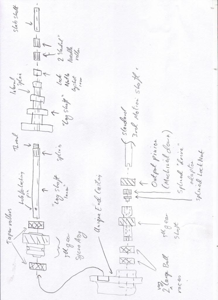

Quick sketch before I go out to give you something to think about over the long weekend!
http://s962.photobucket.com/albums/ae101/troggle/?action=view&current=5speedlayout.jpg
Sorry couldn't get it to load as an image...
Maybe not too clear but best I could do at short notice...
Few notes,
1 and 3rd motion shafts are standard except the out put pinion has been machined down in width to allow a splined drive adaptor to be fitted. The 5th gear shaft is splined to match...
Layshaft assembly is an absolute ***** to assemble, sketch is missing splines for 5th gear syncro assembly.
Layshaft end taper roller goes into a "new" 3rd motion shaft bearing retainer which also locates the revers gear shaft.
Hope that helps...
Last time I tried to explain how this worked on a forum I got called a noob!
Few notes,
Hope that helps...
that does fill in some of the blanks, thanks :D
