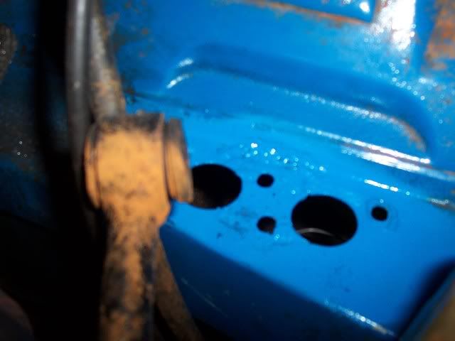

Just removed the steady bracket only to find out that my panel beater didn't weld the previous cracks up when the car was rebuilt a few years ago. The "bridge" of steel between the two master cylinder holes had previously snapped/cracked clean through, I specifically showed him what the problem was and then I wedged the piece back in place so it wouldn't get lost, all he did was paint over it :x . Weather he forgot to weld it or not isn't the point, I took the time and effort to show him what I wanted :!:
RANT
Any way, because this wasn't repaired it allowed even more damage so now I have had to weld this section in myself plus weld up the new crack that ran across the bend where the bulkhead meets the firewall between the two MC holes.

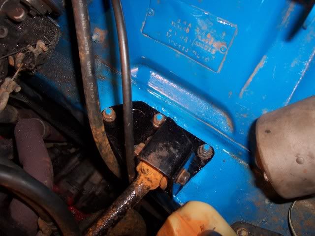

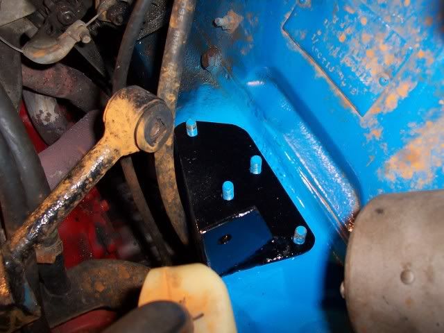

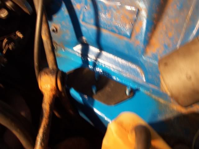

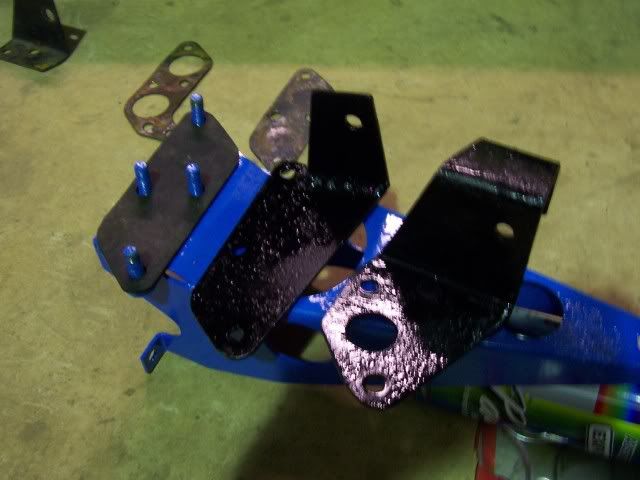

All done.

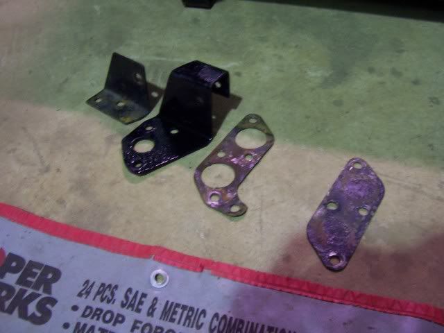

The old bracket, the two sandwich plates are bent and only 1mm thick;
The new bracket is 3mm thick same as the piece being reused (too the right of the pic);
Repaired and painted bulkhead;
New rubber seal;
1st half of the bracket, this joins all four studs together into the steady;
2nd half of the bracket and engine steady in place, this is the only original piece I'm using. It sandwiches the 1st bracket on three of the studs and the bolt through the steady connects both brackets together;
Hopefully this solves all my problems in this area, the pedal box isn't that obvious in the cab either which is great :D .

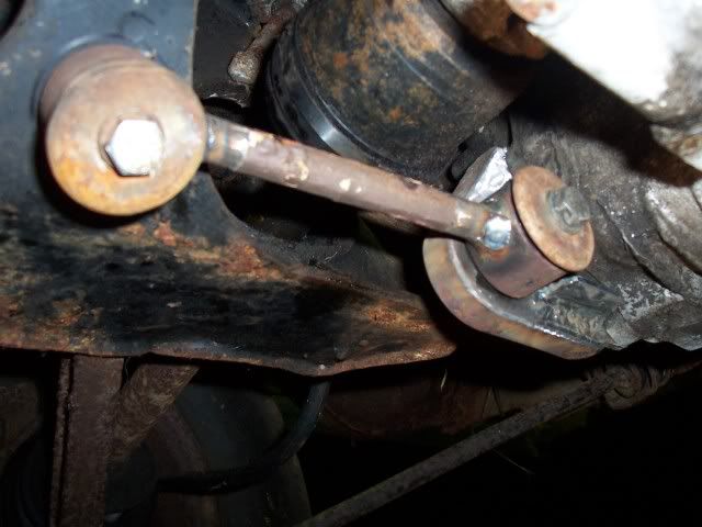

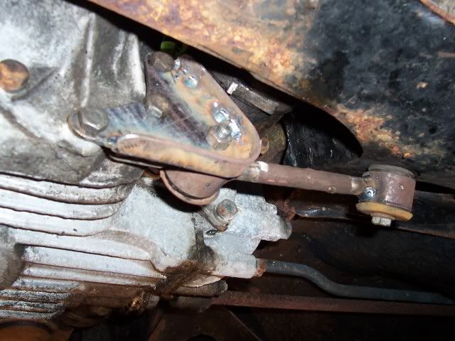

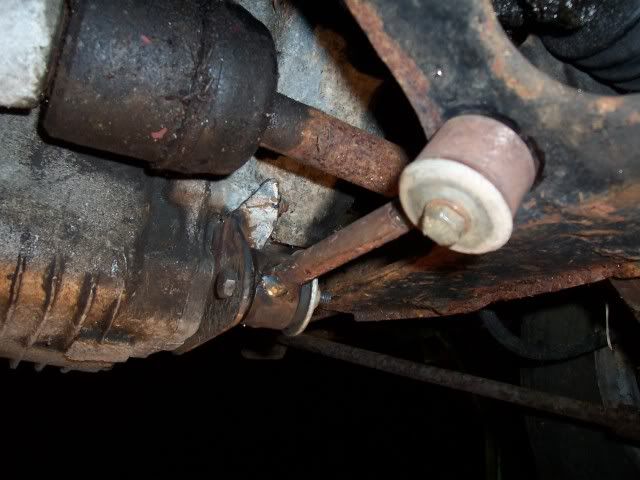

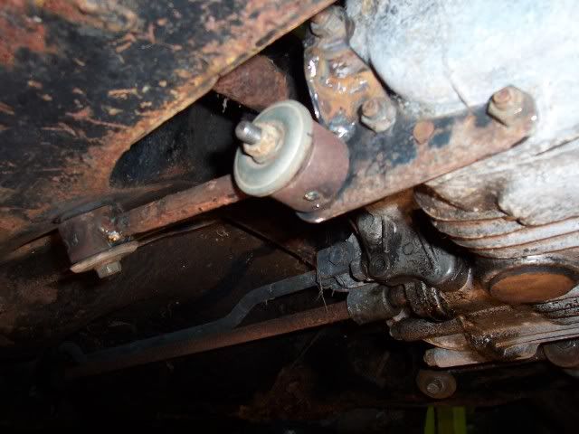

Well I finished building my gearbox stabiliser tonight, all 3mm thick steel plate, std bolts and std rubbers.
Drivers side;
Top stud has a gusset supporting it.
Passengers side;
This one has more gusseting than the drivers because the angle the bar is on looked like it could cause problems quickly.
The mounts on the subframe wings are drilled through the double thickness section which I figure will be the strongest area.
And one final pic from the underside (this mini is not my daily drive just a spare one, that's why it looks so rough);
