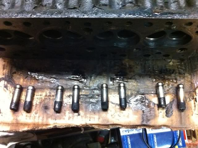

So after a couple of hours in the shed, I have the head apart. A little Ghetto™ played its part getting the valves out in the form of my trusty Quick-Grip hand clamp nee valve spring compressor :D I did well, only one collet went flying across the garage - and I found it! 8)
7 valves had now hard & brittle stem seals fitted - #4 exhaust was missing entirely, #3 exhaust was broken and the others intact. Even though they were extremely brittle it seems the others were still doing their job pretty well after all this time.
Chambers look pretty good, considering the amount of oil being burnt.
A bit of gentle persuasion with a brass drift and BFH had the guides out. You were almost right Mick, all but #4 came out pretty easily.. #4 took a little less gentle persuasion but succumbed regardless.
The guides. Interestingly, 7 are knurled, one is not...
Valve seats also look surprisingly good for 10-year-olds - no sign of pitting or recession. I've always used Flashlube in this motor because I didn't know whether or not it had unleaded seats fitted, and for that matter I've never actually seen a head with them in. Can anyone tell me if this has them?
So, now at least I know what I'm dealing with :)

Looking at your photo, the arrow I've drawn is pointing at what appears to be the edge of a seat insert where it meets the cast iron.... looks like its been converted to me :) Try scratching it with a scribe (or a shank, since we're all ghetto now :P ) and see if you can feel a gap, or a step or something.... but yeah, looks like its been done :)

Yep looks like inserts there to me.

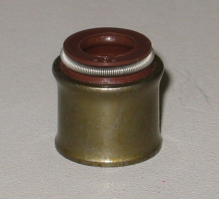

re the valve stem seals- the common black ones (with a spring or not) go hard pretty quick. Buy some Viton ones- many places eg Karcraft stock them now. A bit dearer but worth it.

I have been bringing some Vitons in from USA, but now they are available here it's really not worth the trouble.
BTW some Nissan ones fit too... not sure what motor but I'll find the pic.
Nissan 1400. Looks the same as mine except the seal bit on mine is blue.
They will fit the guides whether they have the groove in, or not. They are a push on fit- but I use a smear of Loctite 262 to be sure, to be sure...
Pic borrowed from our friends in Seth Efrika...
