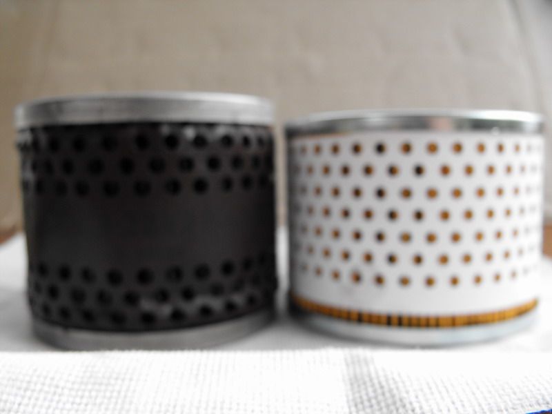

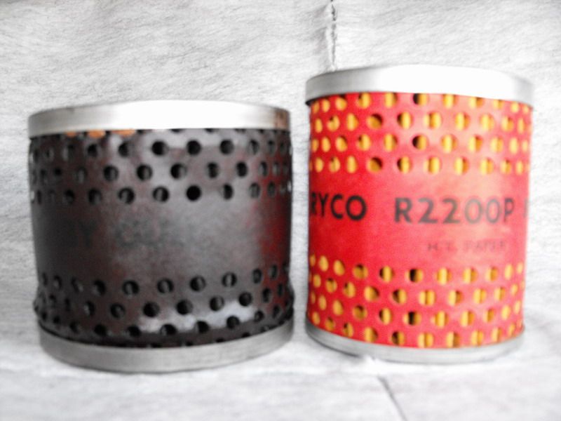

PostPosted: Thu Mar 14, 2013 8:22 pm
Posts: 2663
Location: Muswellbrook -- NSW
Thanks for your help Doc , i'll keep trying , but i might have to modify the 2200 mini cartridge one for the short term .
Here's a pic of the one i have , and a new mini cartridge type .

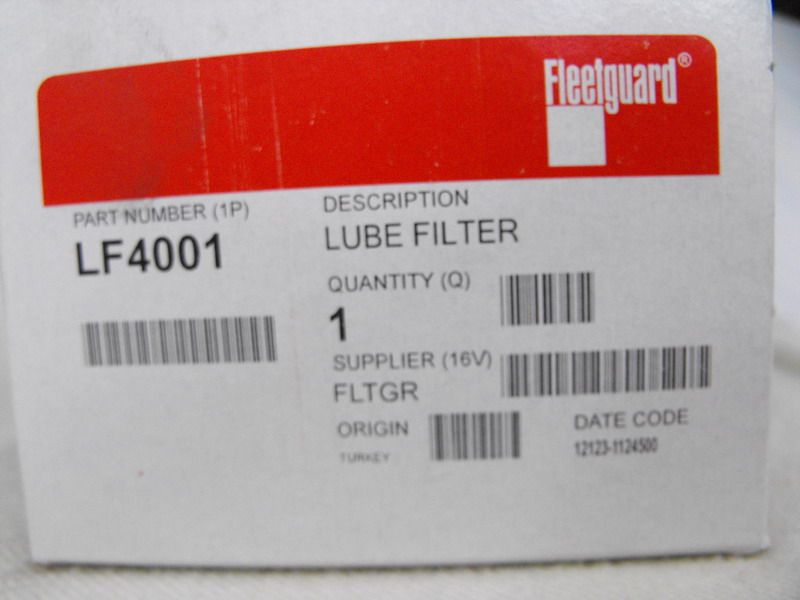

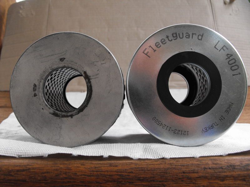

PostPosted: Tue Mar 26, 2013 8:48 pm
Posts: 2663
This may be a help for someone else with a 1300 auto , i found a fleetgaurd filter to suit , as the Ryco filter is NLA .
