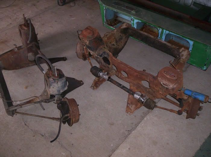

PostPosted: Wed Dec 12, 2012 5:14 pm
Posts: 3398
Location: Quakers Hill Sydney
Here is a dry, early moke subframe next to a hydro frame for comparison.
If you're talking about the blocks welded onto of the front bar on the right hand subframe, they are bumper mounts.

PostPosted: Wed Dec 12, 2012 5:57 pm
I think what he may be referring to is that some mokes had spacers under the cones making them ride higher to increase ground clearance.

I think it's fairly safe to say that the subframes are the same except for the bumper mounts
