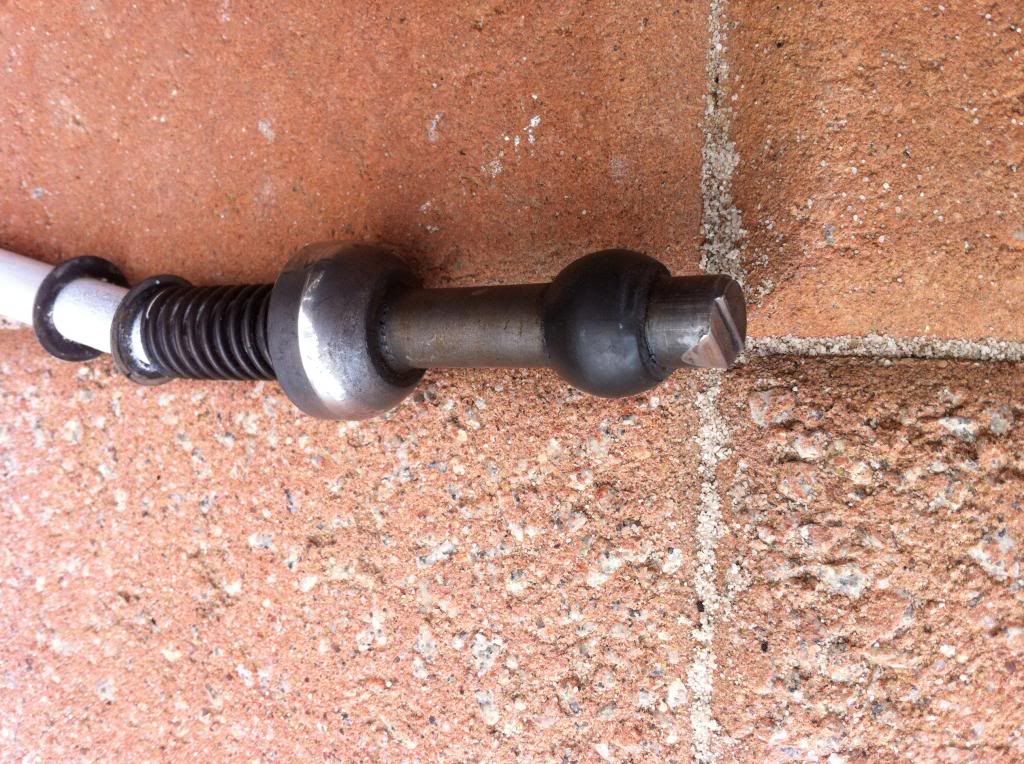

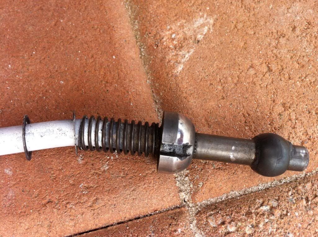

here are some picutures of my gear lever. It would appear there is some wear at the bottom, under the round ball
http://i1238.photobucket.com/albums/ff4 ... ab956b.jpg
http://i1238.photobucket.com/albums/ff4 ... 671c4b.jpg
the box that houses the selector looks fine to me.
John, if you mean the round pins that are in the box , they look round to me...

PostPosted: Sat Jun 15, 2013 12:15 am
The Mini King
Posts: 1338
Location: Windsor, NSW
Your gear lever looks very good. The wear on the bottom is because the lever has not always been lifted high enough when selecting reverse gear. The pins I am talking about are numbered 17 & 18 in the drawing posted before But I think they are going to fine considering how the gear lever looks, I would now Check the connecting sleave and the roll pins

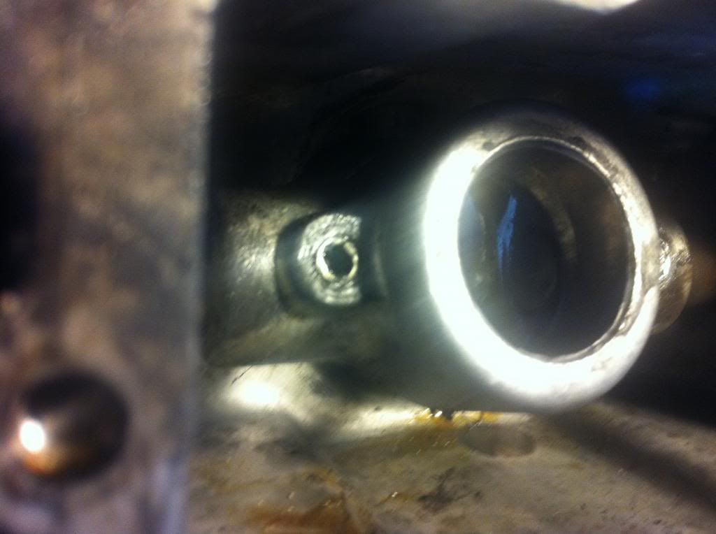

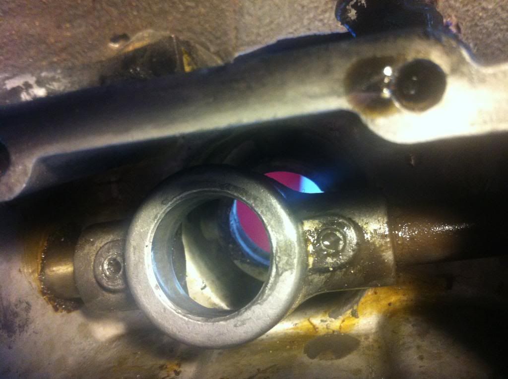

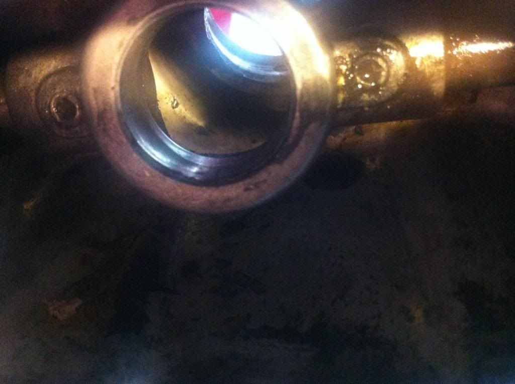

i finally got around to having a closer inspection of my rod change. There selector box looks fine to me, doesnt look like its been bottoming out or something like that. There is some play where the rod goes into the connecting sleeve and into the gearbox... however i read in the haynes manual this is normal.
the roll pins at the selector box appear to be in there tight. However, at the gearbox end, one of the roll pins is quite loose - i can move it back and forward a bit by hand .
not sure what to look for in terms of wear on the connecting sleeve. I dont have punch at the moment so i couldnt remove it but if need be it can be done.
I did check my other mini which is a rod change... it would appear to be the same , the roll pins at the gearbox are not in so tight, there is some play... and i havent had selector issues with this car
I do have some photos but they are pretty crappy.

sorry to bump this again... but can anyone confirm that it sounds like my selector problems are inside the gearbox itself?
