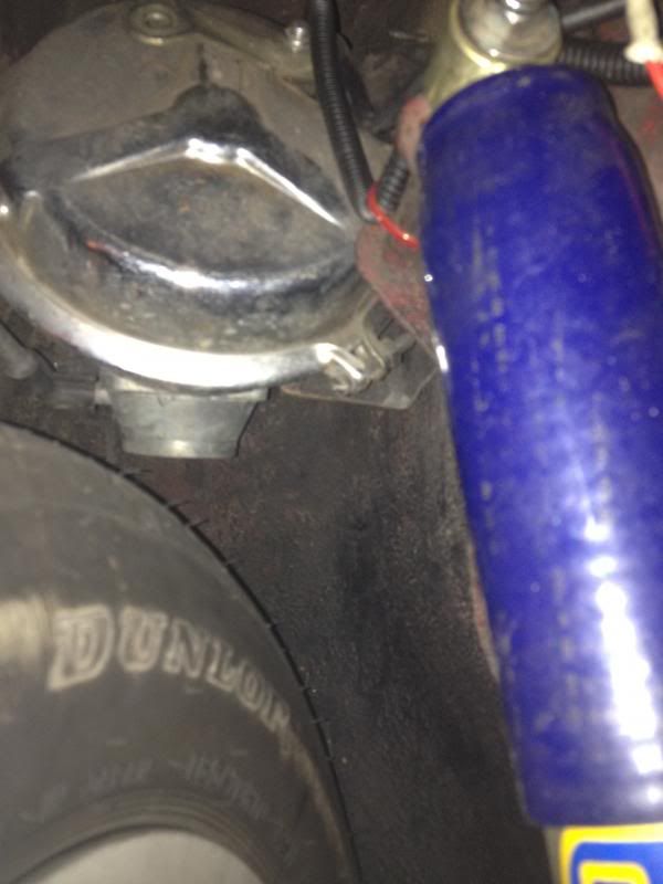

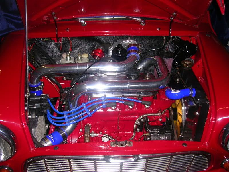

PostPosted: Fri Jul 12, 2013 5:12 pm
Posts: 1170
womble99 wrote:
Interesting fitment, I have heard a few people talk of mounting the booster under the front guard behind the headlight. Anyone seen this fit out or even better have any photos?
with my engine bay full of intercooler and pipe work there was no where to fit the booster so i mounted it in the RHF guard.
Got a pic somewhere...
could not find it but have take a quick one this morning with the wheel still on, not great but you get the idea.
100% Pure A Series Turbo
