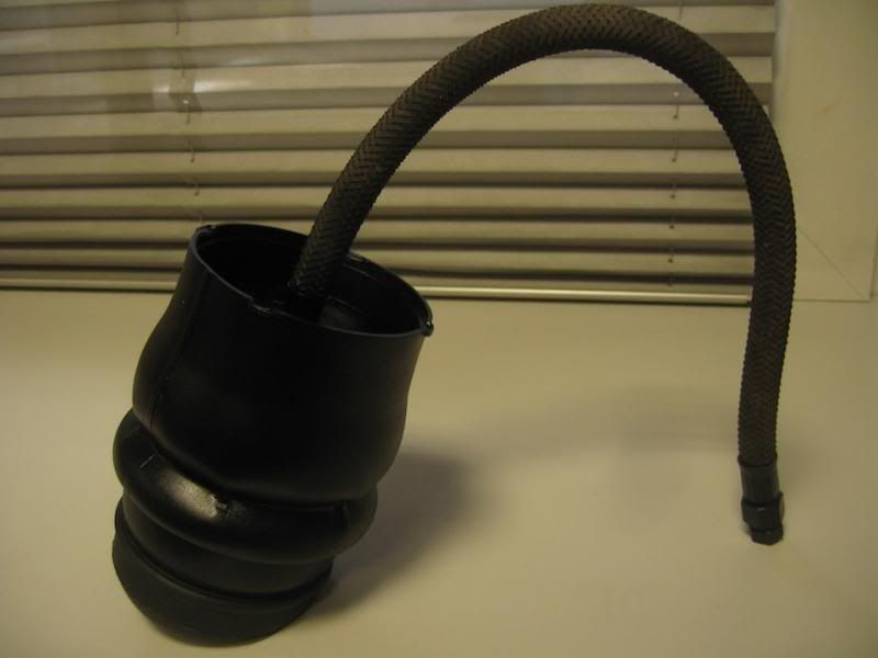

Thanks Bubba, nice find! That is the correct size hose both internal and external, however I highly doubt the pressure specifications of this hose are going to be even close to what we need (or what I would feel safe with installing). Searching Herringbone and Norton, this hose is to supply to and from the oil filter and/or tank, which I cannot see going above 150psi (most gauges sold for the bikes only go to 100psi). We need to double that number, then have a safety factor in my opinion no less than 500psi burst.
That exterior look of the hose in addition to the pressure specs is going to be rare... maybe we'll get lucky and someone at Dunlop has a spool of the stuff in a dark corner of the factory... wishful thinking. Stainless ferrules are what I'm using on my repaired bag and they seam to be doing the trick. I have found a high pressure line that is perfect for these bags, just doesn't have the herringbone look. Still waiting on a price too from my supplier...

The one bag I have repaired I used Pirtek MP-06 hose, this is textile braided, rated @ 500psi and is normally used for oil return lines with push-in barb fittings. However it crimped OK for me when Pirtek did it.
No it is not the right pattern, but if the Dunlop diamond stuff is NLA this stuff does work and it's readily available.

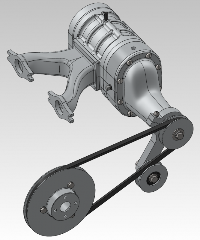

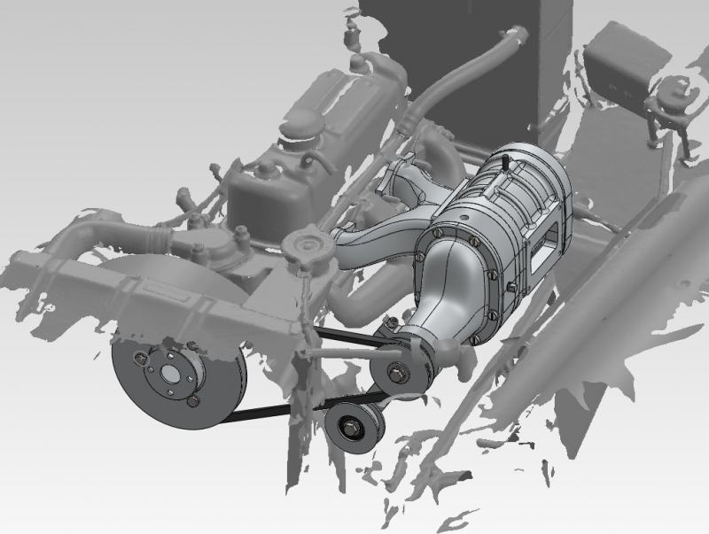

Thanks guys for the kind words. peterb, I had a similar thought as well. Its going to be easier to make a mold to go over a pre existing hose than it is to get a good price of 1000ft of specifically made OE looking hose. I would look into the hose side if at some point we are making replica bags. For now, I'm going to focus on solving any repairing techniques of existing bags... that is, unless someone has the means to fund, say no less than 4000 units. 1000 cars odda fill the market quite quickly? I can draw them up (or even get them 3D scanned), rapid prototype bits, get quotes, and we go from there... Whats the demand? How many cars would you guess are still running hydro? And how accepting is the concourse community going to be toward replica bags? (we're talking gooooood replica, no half-ass stuff passing by me)
For example, here is some work a friend has done recently, working on making a supercharger kit for Austin Healeys...

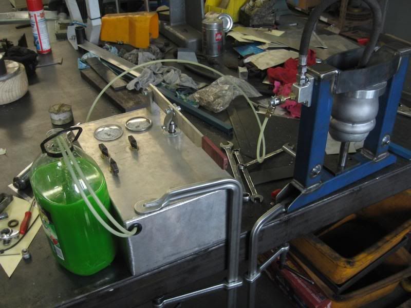

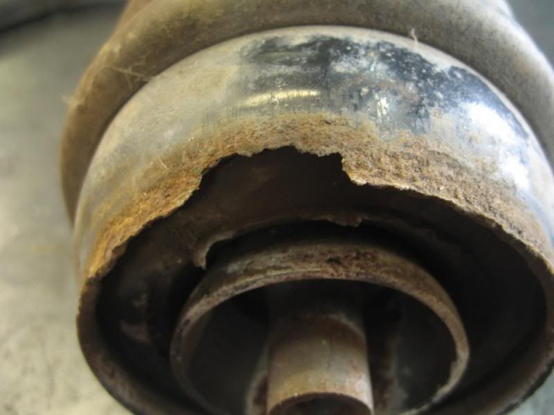

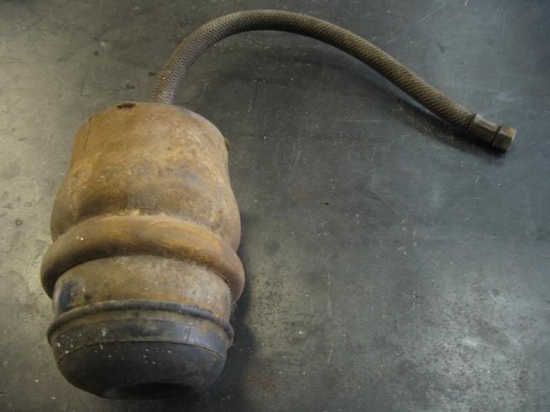

Hello again everyone, just wanted to post a recent bag cleaning I've done. Thanks to Matt (TheMiniMan), I have another chance to get my car on the road for the first time in 30 years… more excitedly, the first time for us to drive the car since acquiring it alittle over 8months ago.
Second hand bag:

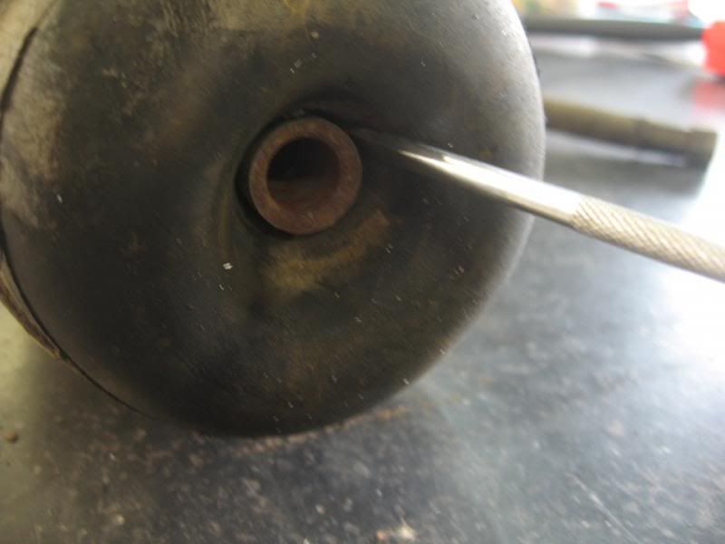

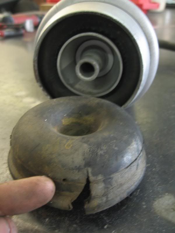

First thing I like to do is pull the skirt dust boot off if its still on. There is no use in keeping these on if the bag is in storage… They hide rust and new boots are cheap. I use a small flat blade screw driver and filet the rubber away from the lower piston shaft. Some of these almost feel glued on.

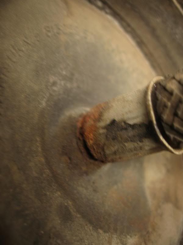

Rusted tapered cylinder… bummer! But not to fear, I don't believe this is will hinder performance or safety. I could eventually, but hopefully by then I will be able to repair or replace them.
Inspect all over, here is some rust starting on the ferrule and inner cone neck:

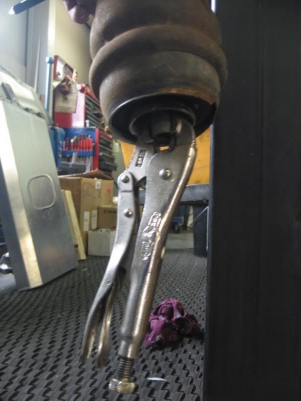

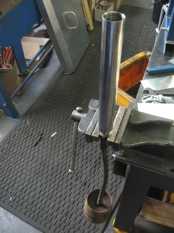

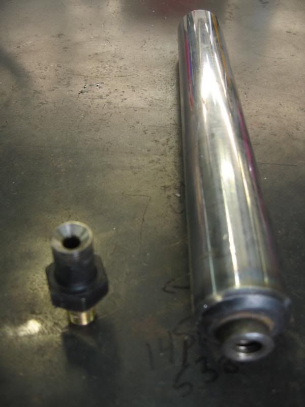

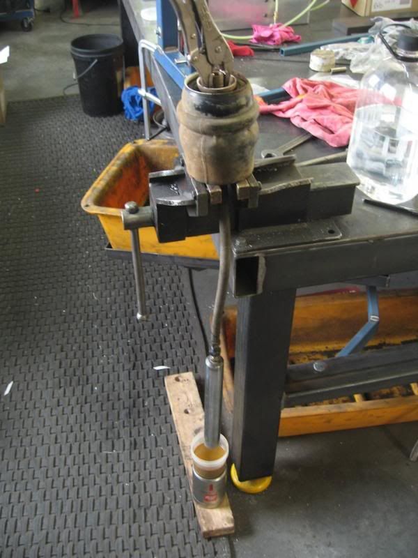

Cleaning the inside of the bags, I made these two items from an old shock body and a 5/8"UNF bolt. Nice to have a lathe, but you could do this with just a drill and vice. Drill the center of the bolt with a small drill first, 3mm, then 8mm. Use a deburring tool in the drill on the threaded side to make an angle seat for the bag connection to seal against. On the other side, drill and tap a 1/4BSP. For the beaker, you can use some PVC tubing and a cap from any hardware supply. 50mm (2") tube should work, 200mm long, glue a cap on, drill and tap 1/4BSP and join it to the bolt. I used about 250ml (1 cup) of methylated spirits each pour.

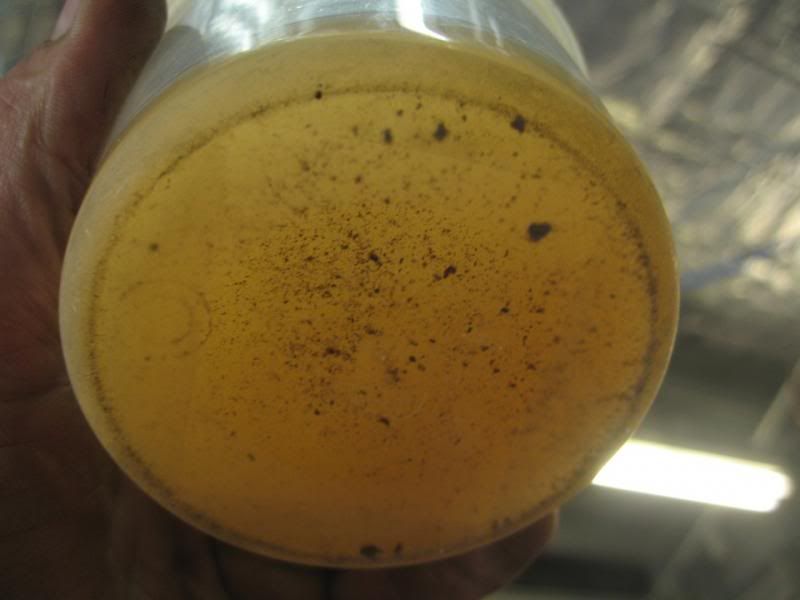

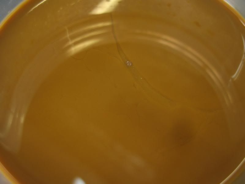

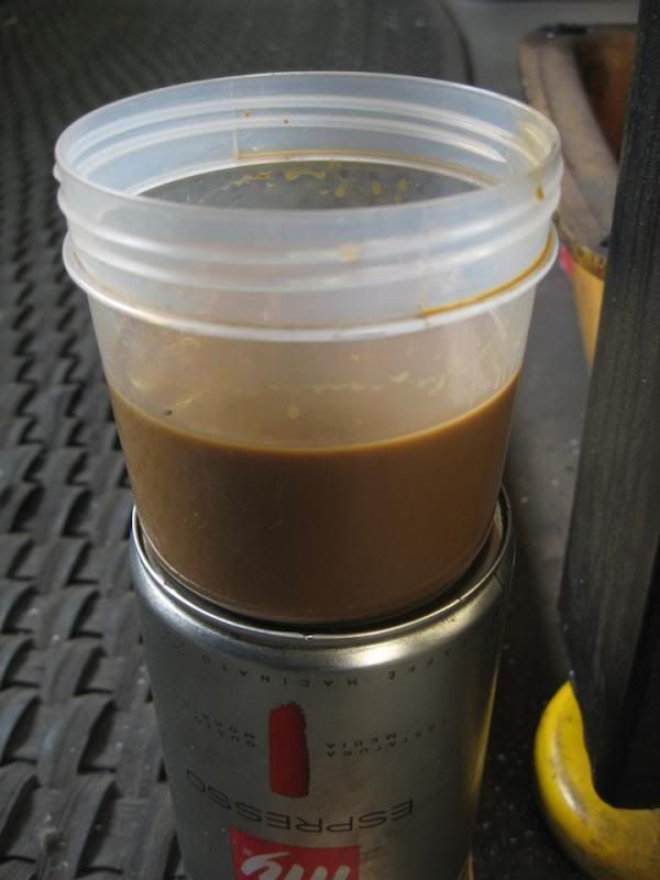

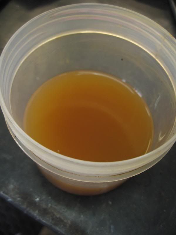

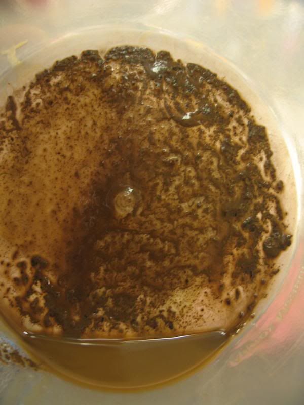

When I cleaned my first batch of bags, I recycled the fluid. From the first pour, I would drain the cloudy liquid into a bigger bucket and wipe the sediment in the trash. Leaving it to sit for a while, you can start to see the water and other fluids separate from the spirits. Pour or better to siphon the cleaner fluid for re-use.
Flushing tools
Fill it up buttercup!
Grab piston and move it around… I like to push and pull up down and sideways to get as much of the spirits in and flushing around to help brake up the gunk.
Drain:
First drain close up:
First drain spirits starting to separate from gunk:
First drain sediment:
Forth drain:
Last flush, fluid much clearer with less sediment:

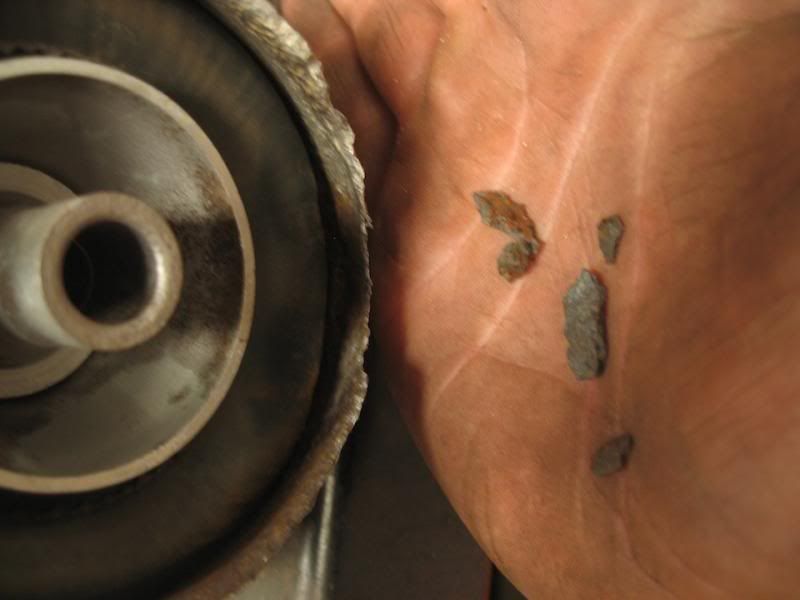

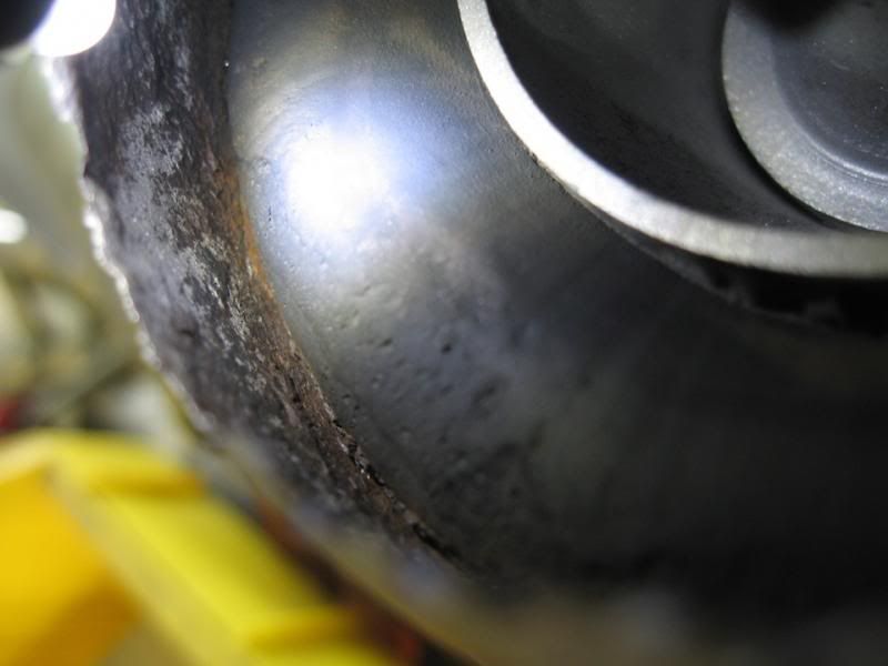

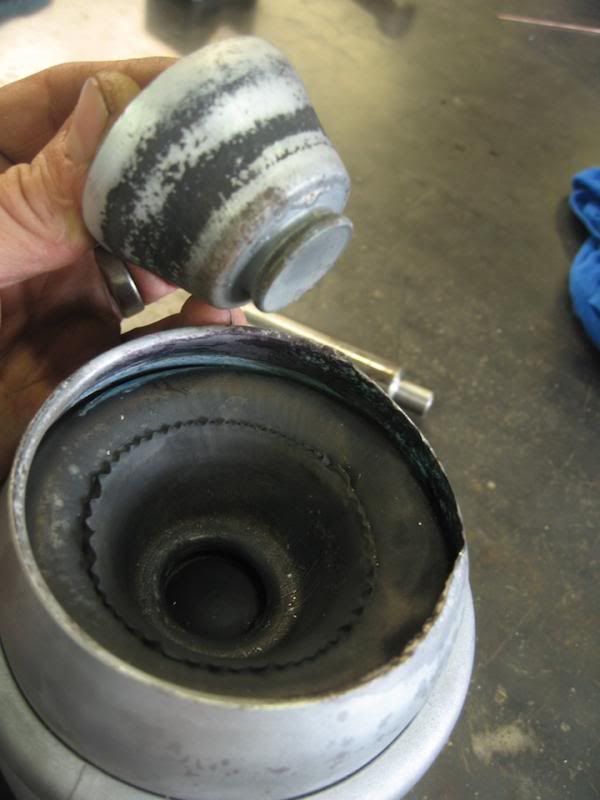

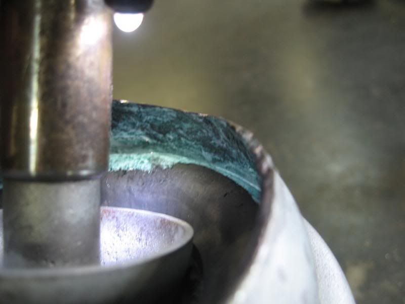

Now we inspect the inside of the tapered cylinder. It was obvious that there was rust from the edge, and looking deeper we see nice chunks of layered rust.

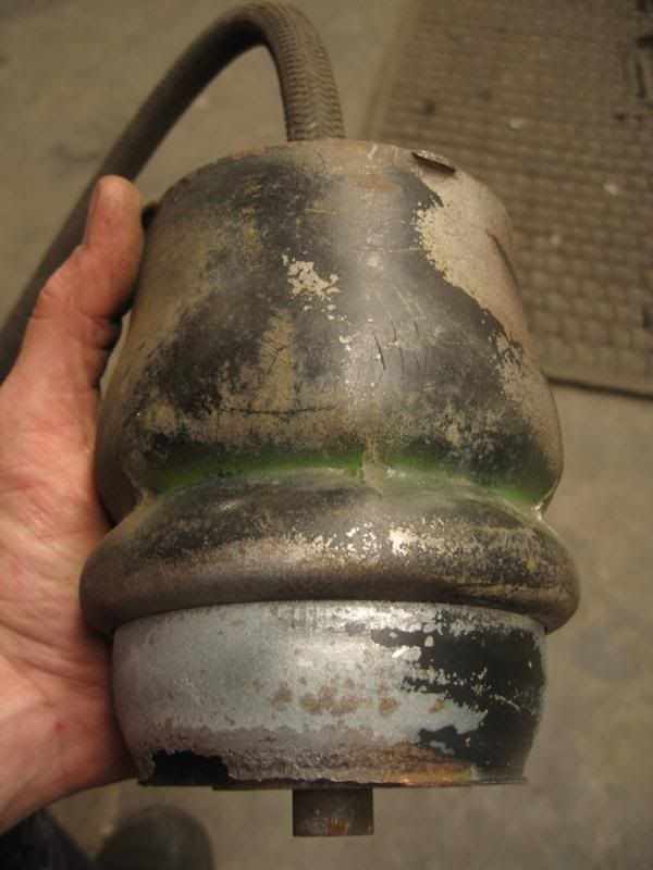

I glass bead blast the bodies, I start with a light blast to reveal any color markings to help identify previous bag types… This has a green band, which confirms makes this a later "normal" 21A1477/21A1804. This will probably be the softer type bag with larger bleed hole.
Green band:
Blasted bag:
Rusted inside of tapered cylinder:
Clean inside of tapered cylinder:
While being most careful to not damage the skirt, I've sanded down some of the thin rusted metal and die grind the sharp edges to a blunt edge. I like Galmet ionize rust converter, with an acid brush, try to get down in the side of the bladder and tapered cylinder.

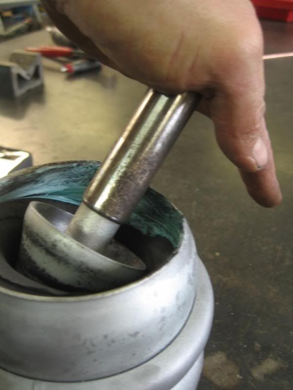

Pushing piston/skirt with tool, or any 1/2" diameter (12.7mm) shaft, you can use a long M12 bolt if you don't have anything else.

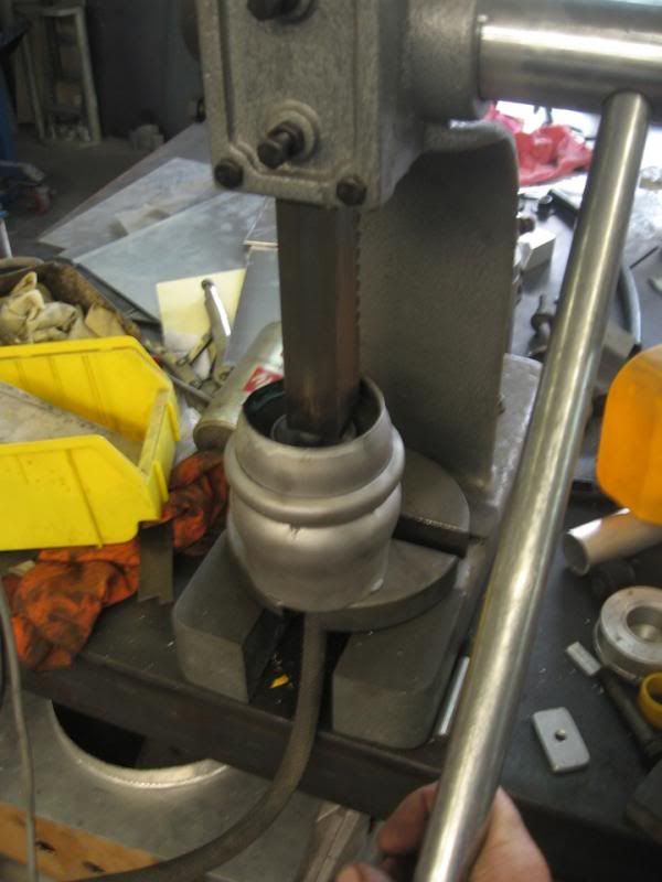

Whoops, I've popped piston out! First time this has happened, but I'm sure it won't be the last...
Pushing piston back in with an arbor press. Not much pressure was needed, standing on it probably would have worked.

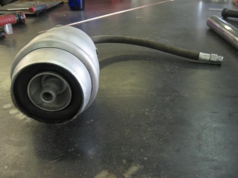

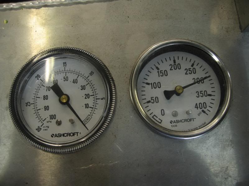

Pressure testing bag setup. I'm using a weak dilute of coolant to water. Pulling fluid from this bottle and draining it back in.
Gauge pressure, 300psi holding for a couple hours… probably should have taken it to 400psi for shits and giggles, and safety. I'll do that when its in the car under "normal" factory conditions. I probably won't go to 450 as the factory suggests as this is not a new bag.
Finished bag. I taped up the rubber flex shaft and tried to cover most of the rubber as the solvents in paint degrades rubber much faster (like the window rubbers and seals that crack quickly after a quick/cheap tap and paint body job)
