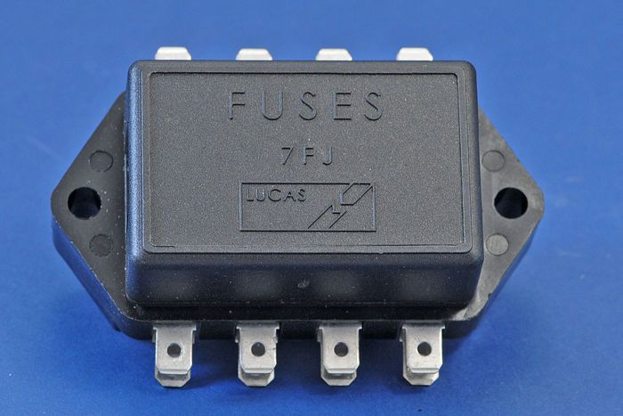

I was looking thru some stuff at work and found this as a possible upgrade option .
Its even a Lucas one. 7fj I think.

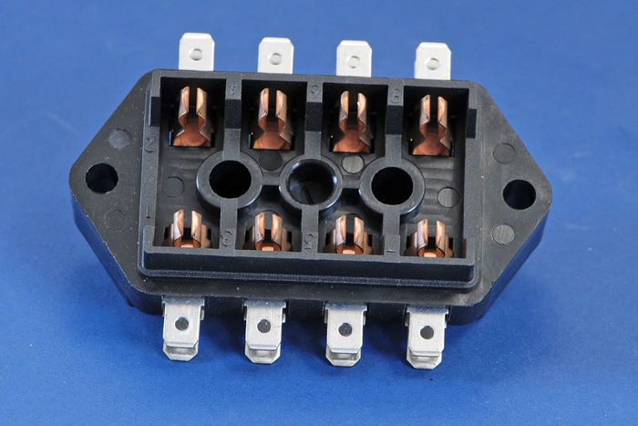

It has dual inputs/outputs for each fuse circuit which would make it easier to put straight in.
What are your opinions??
Here's the details
Surface mounted 4-way fuse box with detachable cover. Accepts glass fuses. Connections via side mounted 6.3mm blade terminals. Has space for two spare fuses.

PostPosted: Mon Jan 20, 2014 9:41 am
Posts: 2729
Looks excellent. Where can you get 'em?
