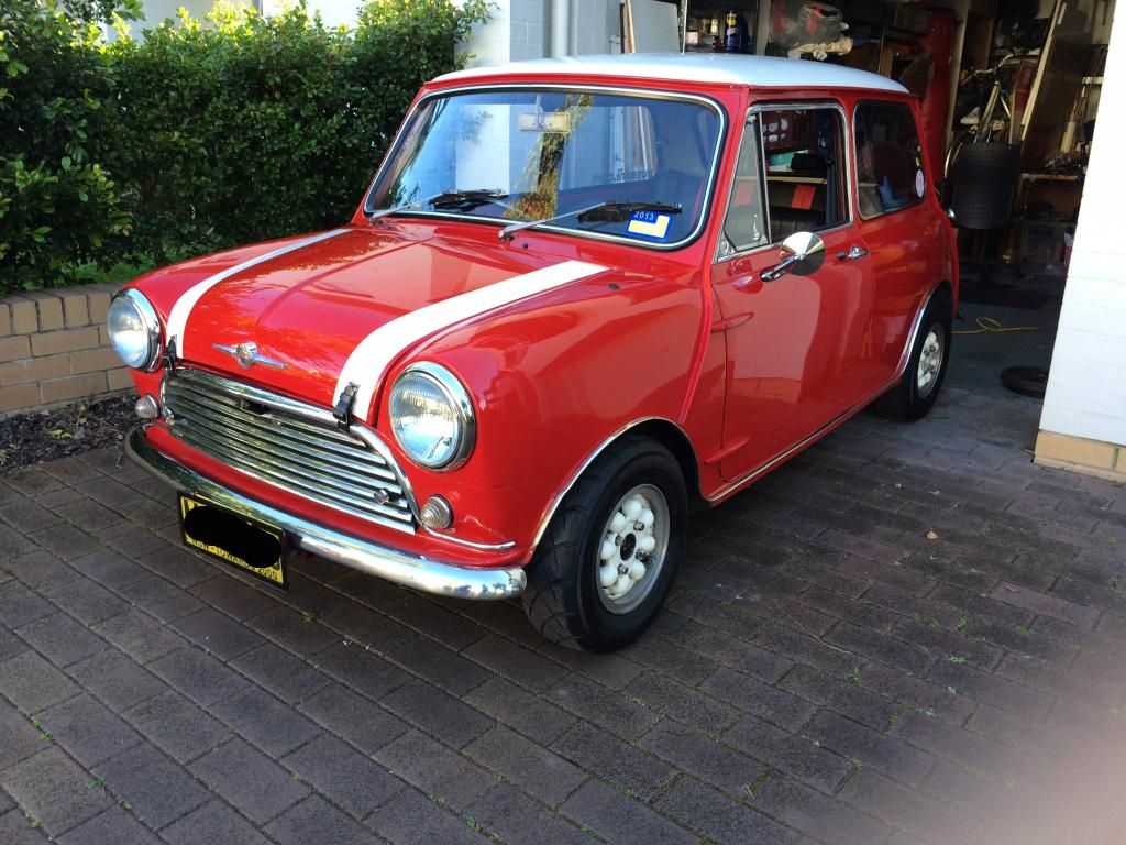

Beware, there are polishes and there are waxes, not the same thing. A "polish" is an abrasive product and takes away paint, a wax on the other hand is to seal your paint from the elements.
Polishing your car should only be done as few times as possible (I do mine once a year max or only when needed) and only to correct your paint finish. A simple way to check if what your using is a polish or a wax, scrub the car with an applicator, if you can see the colour of your car on the applicator then it's an abrasive polish and if you don't know what you're doing you can introduce swirls and all sorts of scratches onto your paint. Beware that clear coated cars, there will be no colours.
Every other time you should be using a wax or synthetic wax like product to protect the car like Mothers California Gold etc 10,000 others. You can wax your car every day to your hearts content and it won't damage the paint and should not leave any scratches or marring. In fact it will only make it shinier (to a certain point, about 2-3 coats is the most, after that you are wasting your wax).
Here she is after 5 or so hours of machine polishing and jewelling, prior to waxing:

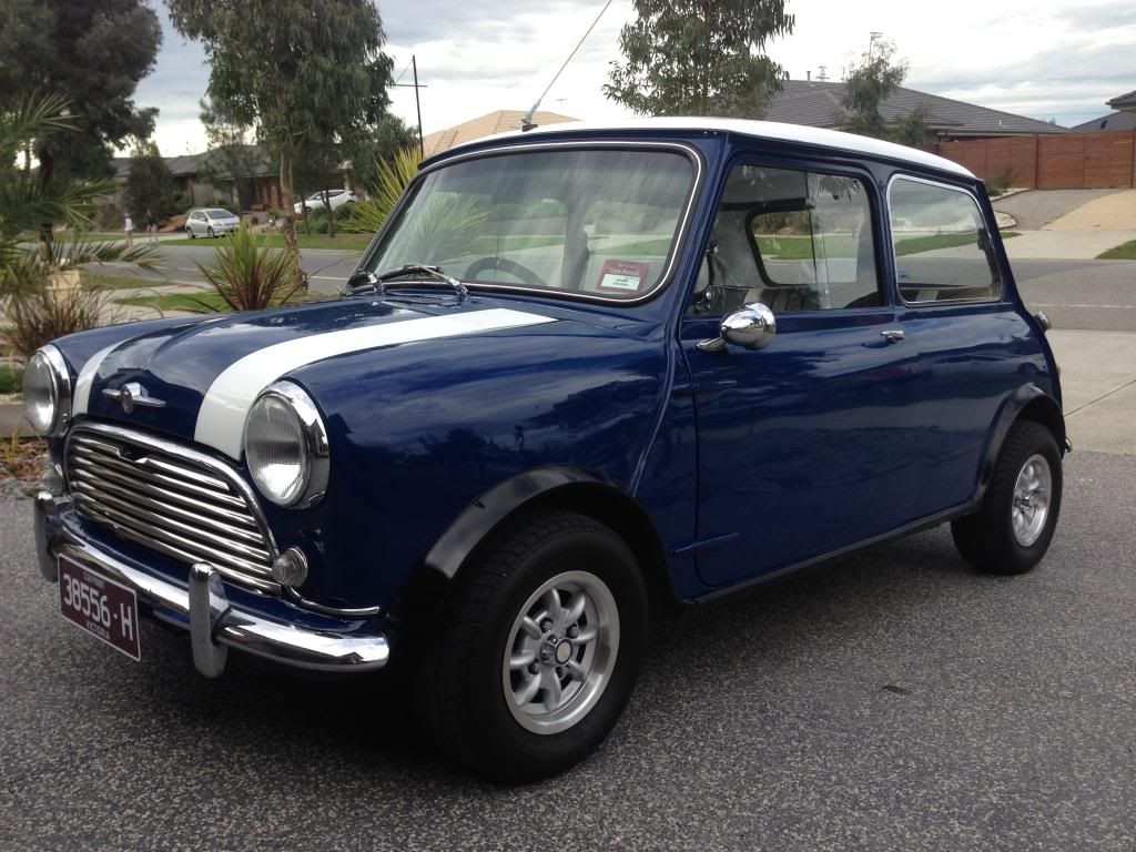

So I finally got around to giving the mini a cut/polish yesterday came up well. Not much change from
Before to after but just looks cleaner..
If I find some energy ill give it a wax today to seal in the sexy goodness. At this stage that's gonna be next weekends job.

Got to be happy with that ! 8) .

Yeah it's looks great just don't get too close to it... Owner before last painted themselves I guess.cos if u paid someone to do it u would be pissed.. There about 4-7 overspray runs and was just painted over the last colour being light/baby blue..
