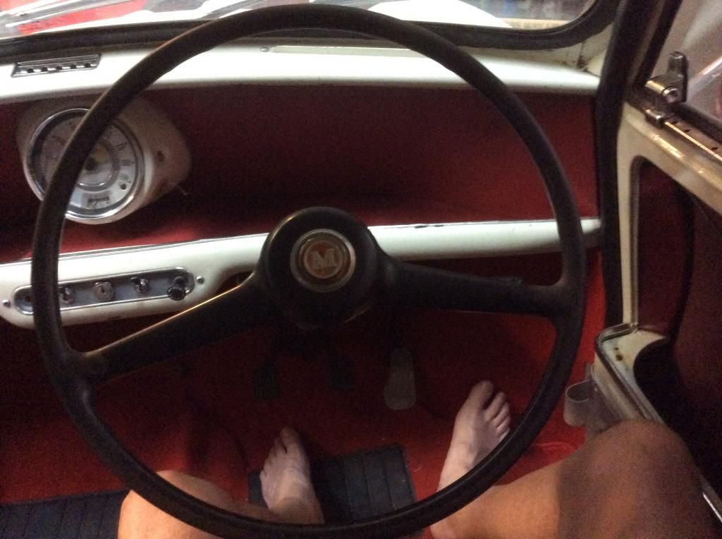

Thanks for all the info everyone.
I want to install my two gauges (water temp and oil pressure) reasonably discreetly.
I want to fit them under the parcel shelf but no matter where you put them they will be obscured by the steering wheel.
I'm thinking of fitting them near the drivers door under the parcel shelf.
I should still be able to see them by moving my head a bit but at least it will keep the interior as standard looking as possible.
What do others do ?

I have mine on the right side under the parcel shelf. I don't have a problem seeing the gauges
What do others do ?
Just be mindful of where you have to access the hole in the firewall ,could make installation easier .
Fine if you don't mind slicing your shins in an accident....the same gauge bracket would work mounted under the top dash board rail :idea:

Phil 850 wrote:
It just gives the junior doctors something to do while the specialist removes the steering column from your chest :|
I understand your concern, but I'm thinking of mounting them under the parcel shelf as I think they are less conspicuous there.
Steering column goes thru the windscreen, not your chest.
Been there, seen this happen. (Xmas 1965). :lol:

The other good reason for the gauges being there is that's where the grommet is.
It's a flimsy holder with a folded edge anyway, I'm sure it'll be the last thing to worry about in a collision!

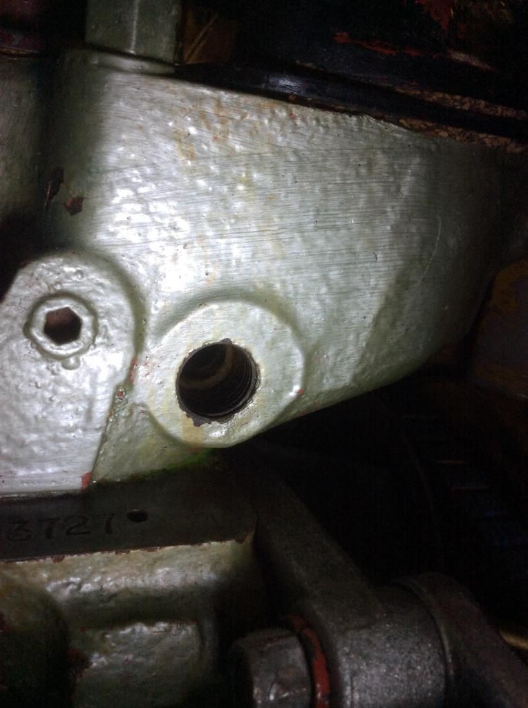

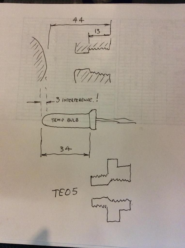

Hi all
Pulled out the old electric temp sensor from the head and found that my head has a seat in it for the mechanical gauge bulb.
Shoved the bulb in and it bottomed out before reaching the seat so I took a few measurements.
As you can see, without the TE05 adaptor the bulb will hit inside the head by about 3mm :|
With the TE05 the bulb should clear by ~10mm if the TE05 is screwed in all the way up to its shoulder. If it doesn't go all the way in there will be even more clearance.
Thanks all for pointing out these differences in heads so my install should go smoothly.
