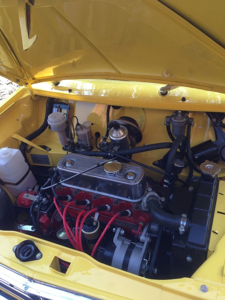

Diesel was that intended for me or for Chris ? If it was for me thanks for the kind offer but mine are pretty new and working fine so no real need for any new ones right now.
See red and shiny !!!
