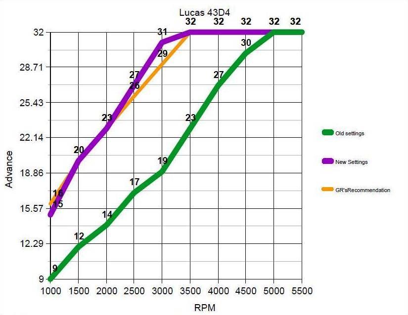

Well I finally got around to playing with my dizzy today. I just removed the secondary spring and finished with a curve close to what GR recommended.
PostPosted: Sun Jul 05, 2015 3:18 pm
Posts: 39757
That looks very good. :)
Did you see any improvement in performance with the changes you made.
Well I have to say that I have broken my golden rule of not doing more than one thing at a time. The car is in bits at the moment. But I am thinking of slapping it back together for a test drive. I will update after I have gone for a thrash.

I once bought a new Pertronix Ignitor II dizzy from the states (dizzy body made in China I think). It had a curve like your original one.
In my 1360, it was effing useless- no low or midrange torque when max advance was set at 4000 as per usual. Top end was OK.
So I ripped it off and put the modded Pulsar dizzy back in, same curve as the screenshot I posted. I found INSTANT torque improvement.

Posts: 5123
Location: The Internet
Update. Took it for a run today and the changes i made have dropped my dead spot 1000rpm. Might change my main jets from 160 to 170 and see it that helps.
