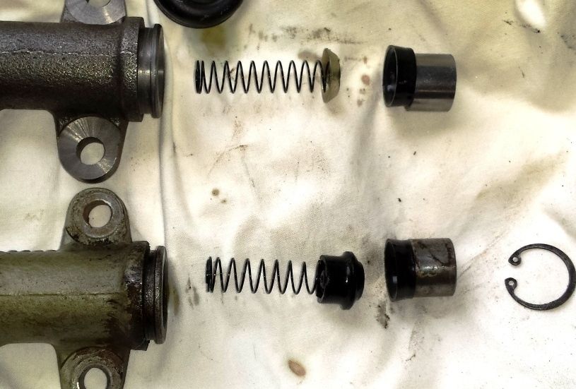

The cup expander won't give you more throw. It just helps support the seal. I just put a GSY110/180-657 clutch slave cyl in my car and used the old spreader from my original one. The one i put in should have a bit more throw because there is no circlip to stop the piston.
Not the best photo but it shows how flimsy the new spreaders are.
